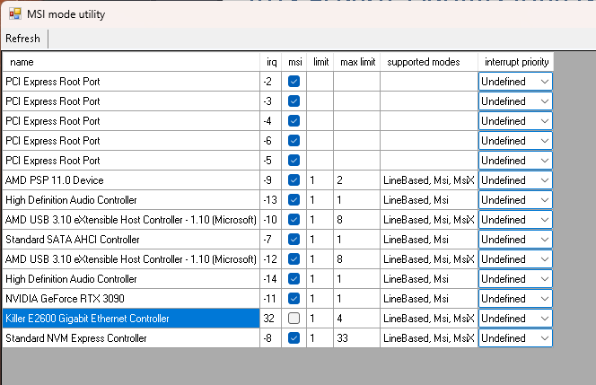

Hello sir thanks for sharing your Windows Tweaks, I was wondering my windows 10 is somehow broken as you can see the MSI mode utility shows weird numbers My Nvidia GPU 1060 has like limit blank, max limit 1, the ethernet controller too (limit 1) max limit 4
as you can see here in the image: (tried to set all normal because they were set undefined, I was thinking If i set to normal they will behave better, as I have a horrendous desync in games like counter strike.
Hope you can see the image:
https://i.imgur.com/pS03sKM.png
In the testing I've done, I barely noticed a difference in the MSI settings. However, I have it here in the guide because it can make a big impact depending on the system and there were obviously bad settings leaving it on default.

As you mention in the MSI Tweaks section, you're currently using Limit "1" for all devices and have "Undefined" interrupt priority.
Somehow, when I set my Network card to limit 1, it completely broke the internet access. I have some error saying something like the device cannot start. It's fixed by uninstalling and reinstalling the driver and keeping the value as the default one (5). So can I ask, is it any different if I use limit 1 for all devices except the Network card?

The reason I'm using 1 on each is to eliminate problems from being introduced. It seems like changing this setting is introducing a problem for you, so it might be best to keep it on default. Since my NIC is the weakest component in my system, I recently started testing the NIC in legacy mode (non-MSI), which does cause higher latency in CSGO netgraph, but the connection seems more accurate with less rubber-band corrections happening. In UE4 games I'm also noticing less desync, and it feels like almost every input counts instead of having moments where no inputs count for what feels like hundreds of milliseconds. I'm still testing this legacy setting but it could be worth trying for you as well.
If I'm losing a few ms of latency for more accurate gameplay, that's a tradeoff worth making. This also applies to your question of losing some latency when disabling HPET. If the gameplay feels more accurate, it's probably worth the trade. Using newer NIC driver + current settings probably costs me 3-5ms on every input but it's worth it because those 3-5ms of delay give me much more consistent gameplay where inputs don't drop-out and desync/resync events aren't as common.
I just double-checked and the sv setting in net_graph shows a constant 4-5ms instead of the 0-1 it showed before switching to NIC legacy. It's completely possible my settings for NIC could be wrong or bad generalized advice, I'm testing and sharing as I go. I've spent months eliminating multiple variables so now I'm going back through and focusing more on network.

Here is a quick update:
Legacy NIC is running very smooth, my characters in-game feel like they are inside their hitboxes most of the time. This is a big improvement from that feeling being rare using MSI mode. Air dribbling in Rocket League seems very achievable online, as the feeling of hitting the ball is pretty consistent now. Before, it would feel like my car just ran into a brick or a blanket and then I would have to adjust out of a mistake.
I also increased NIC to 2 channels, just in case a full channel is needed for each direction (full duplexing) and so far things seem the same if not a bit better. (EDIT: only 1 channel is assigned when using this setting, so no difference)
It could be worth experimenting with IRQ mode on devices that are adding latency like NIC, audio, etc. MSI is pretty new outside of GPU so expecting the drivers to work as well in MSI mode as they do in IRQ mode might be something to reconsider. As a generalized guess, older devices likely run better on IRQ than on MSI.

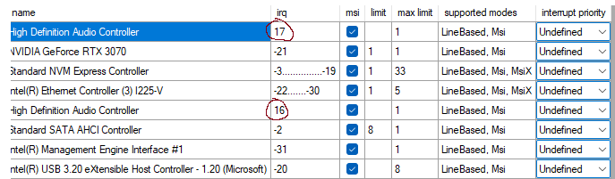

by yuv1
Do I want these IRQ values negative for MSI mode? How do I achieve that
