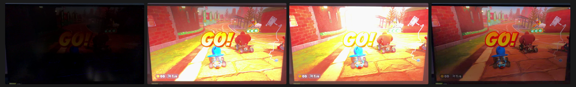

I filmed the 60hz mode with my phone's 240fps slowmo (flashing warning). Looks like a full screen pulse, unless it's doing something unexpected that would need a faster camera to see. I assume if it was rolling in any way, the camera and screen would eventually desync slightly and show frames with the screen partially illuminated. That effect only happens on camera when I try ≥120hz
I recorded it using my iPhone and I see the screen partially lit so its strobing down the screen, I see full black frames too. it looks really good even at full brightness on my Switch 2 playing Mario Kart, colours really pop!
I see it very different to that video.
