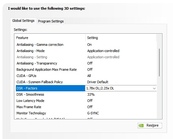

Argus wrote: ↑
16 Mar 2026, 16:51
Does anyone have confirmation whether any of these monitors use DSC or not? I found I was unable to use DLDSR on the Acer monitor but I'm not sure if that's indicative of DSC being on or not.
Based on TFTCentral's review that the ASUS supports HDMI 2.1 FRL5, the display employs DSC on both HDMI & DP.
If it was FRL6, you'd be able to run without DSC through HDMi, which means you'd be able to use DLDSR

Argus wrote: ↑
16 Mar 2026, 16:51
I think I can use DSR on mine, if this is what you mean:
