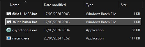

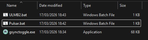

You can make a G-sync on off toggle using 2 bat files and this program:
https://github.com/FrogTheFrog/gsync-toggle
Quick way to flip from Pulsar mode to ULMB2 mode with a double click.
gsync toggle.jpg (21.11 KiB) Viewed 79247 times

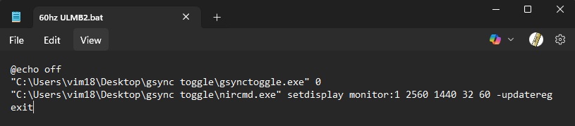

yeah you need this too: https://www.nirsoft.net/utils/nircmd.html
ULMB2 toggle.jpg (28.2 KiB) Viewed 79195 times
gsync toggle.jpg (26.68 KiB) Viewed 79195 times

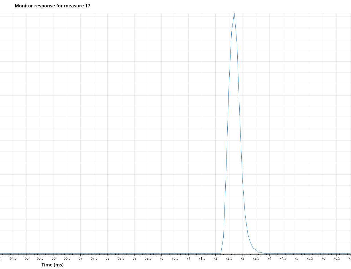

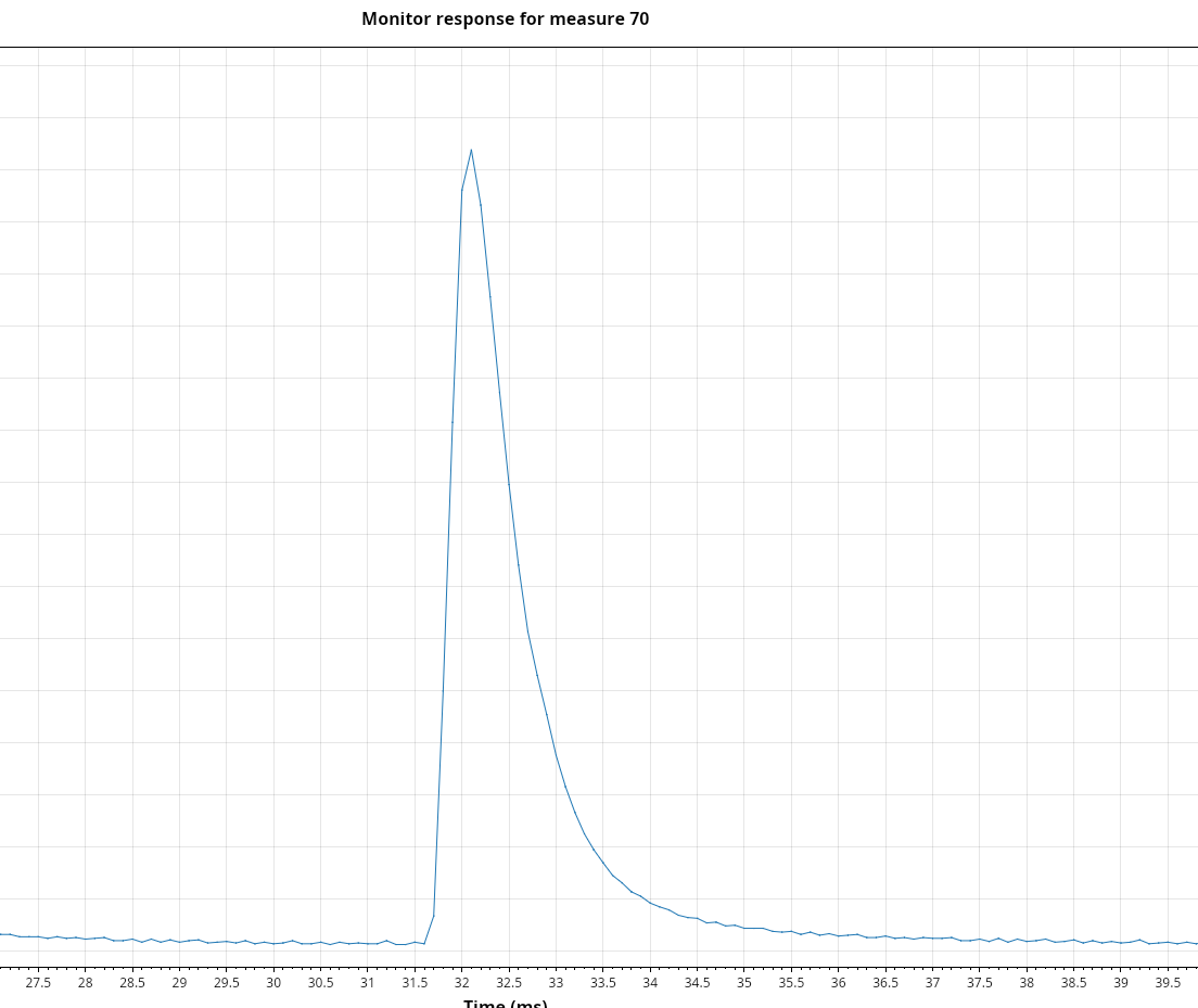

I have this device that is used for lag testing systems specifically for smash melee setups on pc (Button press to average 0-80% transition completion). Kinda similar idea to the LDAT. I'm sure an actual oscilloscope would be better, but this is the persistence of the 60hz ulmb mode 10PW vs. my Sony E400 CRT measured on a lossless adapter.
Asus monitor
ulmb 2 60hz losless adapter test.png (37.22 KiB) Viewed 78940 times
CRT
Sony E400 CRT response lossless test.png (39.11 KiB) Viewed 78940 times
It seems to report the ULMB pulses around 1800nits. Take that with a grain of salt, this thing is meant to be a gamecube adapter with a lag test feature, not a calibrated display tester ;)

Post by brownvim » 18 Mar 2026, 04:20
edgintheledge wrote: ↑
18 Mar 2026, 01:58
Asus monitor
CRT
Interesting, it’s been a few years since I played on a FW900 CRT but I do remember the phosphor trails it would leave.
From memory the 10 pulse width at 60hz looks cleaner than CRT, how’s it compare to your CRT?
It’s too dim for me, I use it around 100 to 50 which still blows away an OLED at 60hz.
