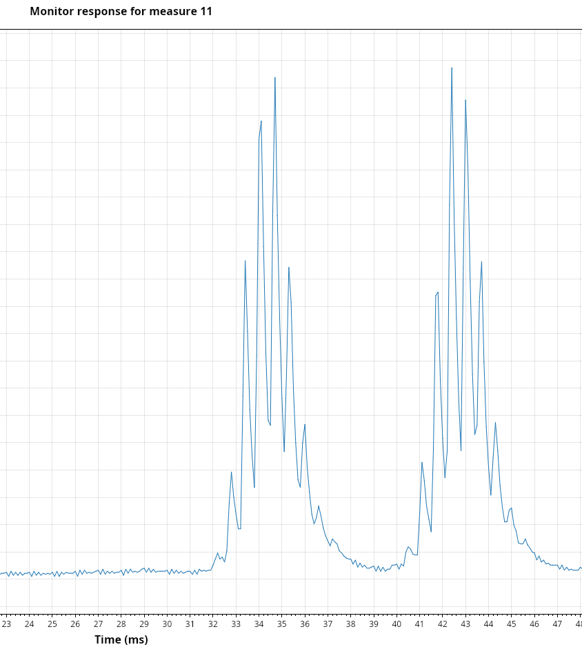

Went ahead and tested ULMB at 120, 240, and 360 as well just for fun
120
lossless120 ulmb.png (67.6 KiB) Viewed 78616 times
240
lossless240 ulmb.png (72.38 KiB) Viewed 78616 times
360
lossless360 ulmb.png (66.01 KiB) Viewed 78616 times
Not sure what's up with the graphs getting all spiky instead of one clean pulse as before. Possibly the individual "steps" of brightness as the roll goes by? (Assuming that the lossless adapter isn't the bottleneck... again, it's not exactly meant for this!). This could suggest that the 60hz implementation is indeed different than the higher refresh rate modes. My bet is still on it not rolling at 60hz. The clarity I see with my eyes, plus scan out skew disappearing in the 60hz strobe (yet present in 120+ ULMB & pulsar) seems to agree. When I flick my eyes, every pulse with the ulmb 60hz mode stays perfectly straight. The behavior matches what I have personally observed with OLED BFI, VR headsets, and Dyac screens which are all global strobes to my knowledge.
