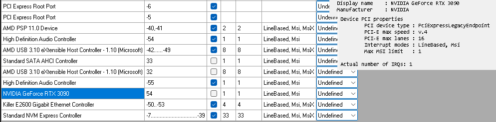

yuv1 wrote:
28 Aug 2023, 23:56
Do I want these IRQ values negative for MSI mode? How do I achieve that
Press Apply and restart PC. I suspect realtek audio could be another device that works best in legacy but haven't tested this idea yet.

I found Legacy devices are listed as "PciExpressLegacyEndpoint" in MSI Utility under device type. I'm now testing only the 3 devices that have this designation as Legacy. NIC was not one, so I'm currently testing with it on MSI and will check back on it later. So far the results seem promising.
Edit:
This did not work out well at all. Testing in CSGO FPS was dropping to 300s and 200s, and then the computer completely locked up. The NIC lag also returned, so I switched back to everything MSI and NIC legacy.
