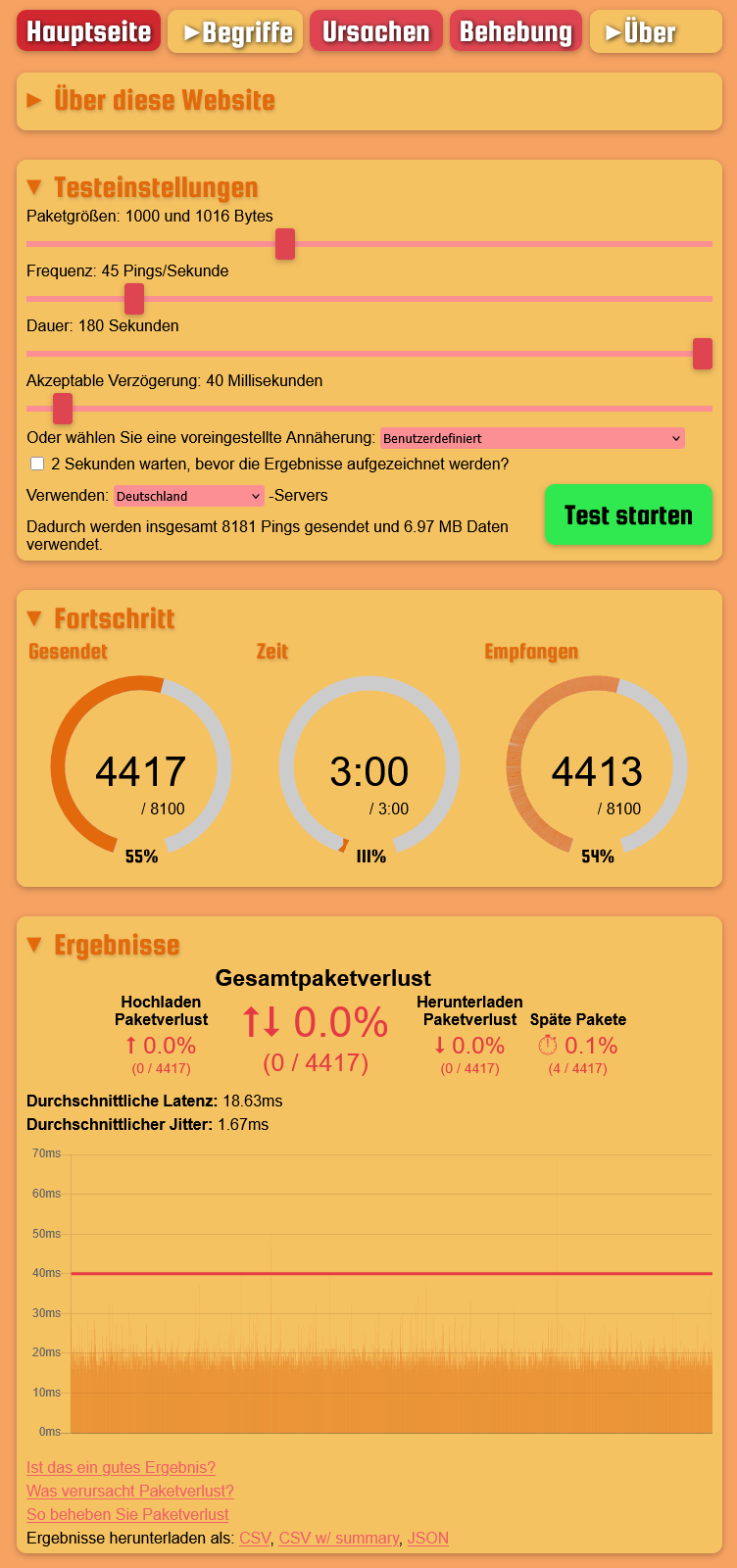

There is some hella weird stuff going on here. That result doesn't look right AT ALL. Something's terribly off. You've set the test in a way that it should send out 8181 packets. However, it only sent 4417? It shows it spent 111% of time, even though it's 3:00 out of 3:00? There's 4417 packets sent but only 4413 received, yet the result shows 0.0% loss? This is one hell of a result I've not seen before. I'm turbo giga mega hyper ultra surprised this doesn't show up in the game's diagnostic overlay somehow.
One thing upfront, don't even try WiFi, it'll always be worse and you should never use WiFi for gaming scenarios ever. Always use a wired connection.
Sadly I can't tell you what the cause of this is. It might be your ISP, it might be your NIC being borked, it might be Windows settings if you've changed any at this point. You might try one thing that immediately comes to my mind here, it's related to interrupt moderation which I've seen cause issues similar to this before.
Try this: Right-click your windows button in the bottom left, select "Device Manager" or "Geräte-Manager", in the new window find "Network adapters" and double-click on your network adapter. If there's multiple, repeat for all of them. A new window comes up with multiple columns. Find "Advanced" and it should present you with some settings. Find "Interrupt Moderation" and set it to "Disabled". Next, find "Flow Control" and also set it to "Disabled". Last, find any setting that mentions energy saving and disable those. For me, that's "Advanced EEE", "Energy-Efficient Ethernet", "Gigabit Lite", "Green Ethernet" and "Power Saving Mode". After changing all of these, click OK.
Next, go back to your FritzBox Support page where we went earlier. Instead of going to "Paketmitschnitte", scroll down all the way to the bottom and find "Ethernet-Kompatibilität". Check the box that says "EEE (Energy Efficient Ethernet) deaktivieren". Click on "Einstellung übernehmen" after.
If you can't find that setting there, it's probably been moved to the new location in the UI. Go back to the usual FritzBox landing page, click on "Heimnetz" -> "Netzwerk" -> "Netzwerkeinstellungen". You should be able the see and set the EEE status here. Disable it for all the LAN ports.
Try the packet loss test again. If that shows the same result again, you can maybe change the Ethernet cable but that's about as much as I can think of right now.

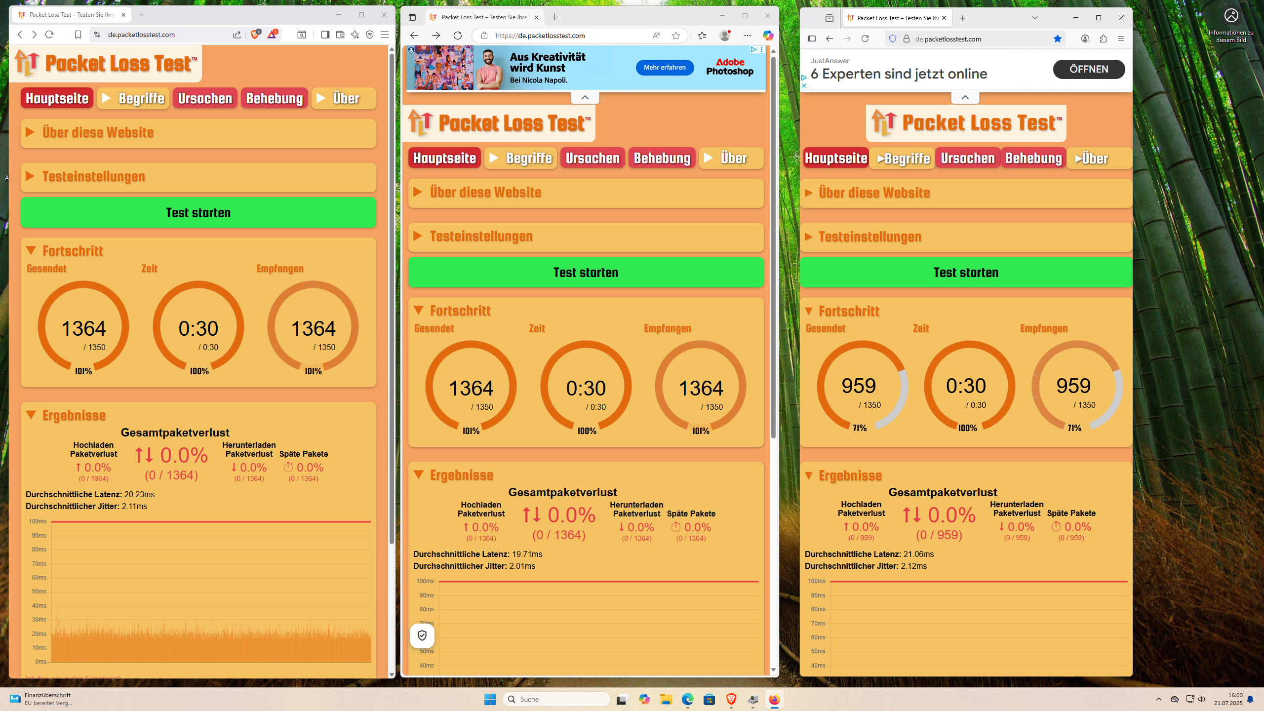

I think I've found the problem.
It's Firefox.
I ran Brave, Microsoft Edge, and Firefox side by side, and only Firefox was the test acting up.

LaggyTyp wrote: ↑
21 Jul 2025, 13:36
It's Firefox.
This does indeed look a lot better. A completely normal result without any anomalies and no packetloss. Perfect! This all but confirms, in my opinion, that there's nothing wrong with your internet connection. There's also nothing wrong with your NIC or your computer hardware. There were good hints that the internet was fine, because you didn't spot anything within the game's HUD that would indicate network problems, and these results all but confirm it.
This effectively eliminates the internet connection as a variable, so I would look at different options and subforums here. It's up to you if you want to participate in them, because as you've seen in this thread, you'll likely be ridiculed for just trying to get help / helping others, but your choice. I'm not going there any more, but others might put themselves through it. I'm reading through it regularly and a real solution for this problem hasn't been found yet. If I'm the person to find something that might help you, I'm making sure to DM you.
