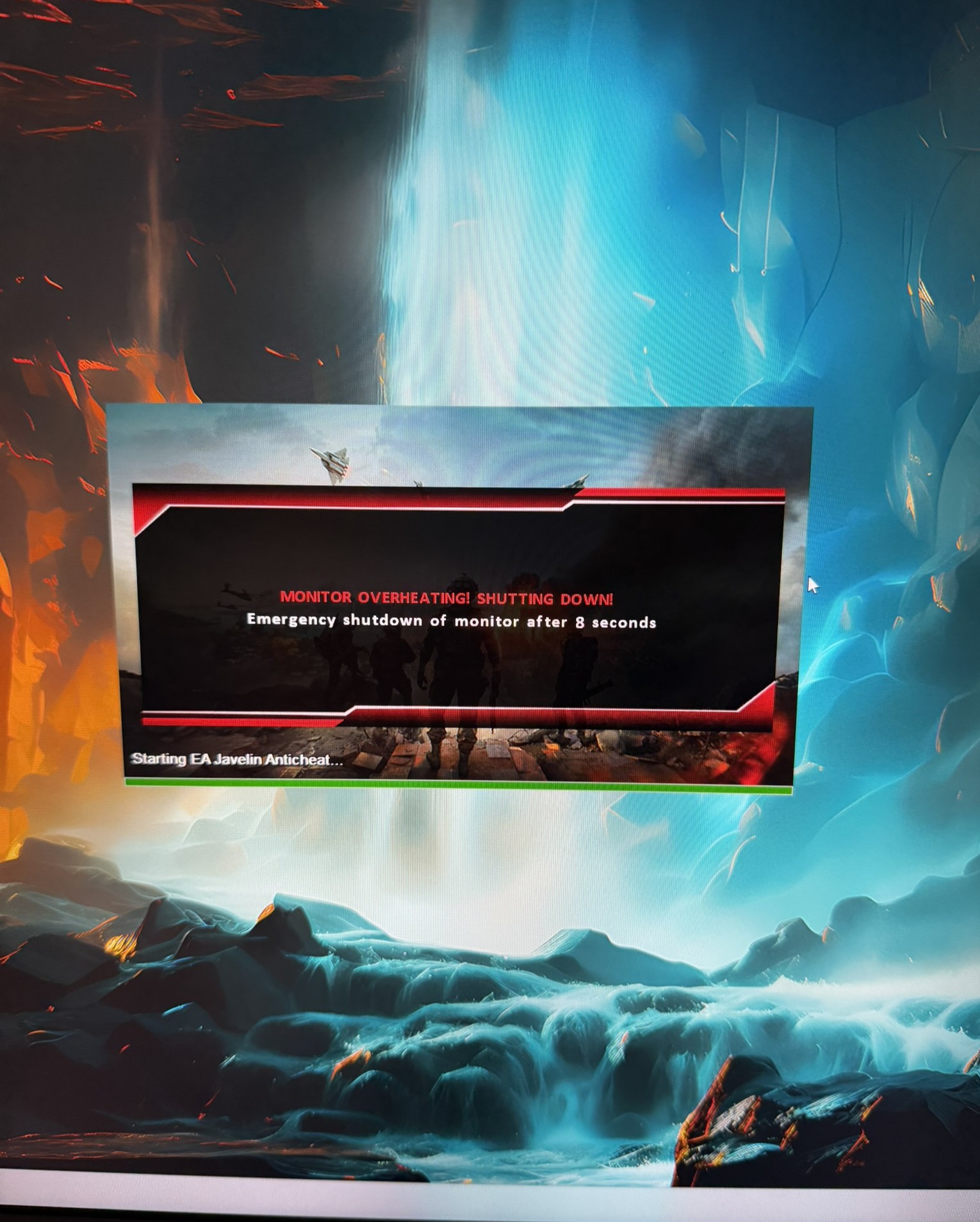

I got this monitor on Friday but had really bad overheating issues. It would immediately thermal throttle and shut down if I even tried to start a game with Pulsar on. Sometimes it would overheat just while having Chrome open on the screen. The only way I was able to game on it a little bit with Pulsar on was to reduce the refresh rate to 240hz and turn the brightness all the way down. Luckily I got it at Microcenter so I was able to exchange it for another unit yesterday. Haven't experienced any overheating with the new unit so far in my brief testing while gaming with Pulsar on and brightness at 350-400, so I'm really hoping the first one was just a faulty unit and not a broader problem with the model.
- IMG_3343.JPG (454.99 KiB) Viewed 5599 times
