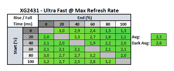

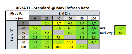

namcost wrote: ↑
02 Dec 2021, 19:39
Oh wow man, its a first! Confirmed fast IPS, a little faster panel than 2019 gen. Seems to be as nicely tuned as XG270.
It would be great if u managed to get 0-100 times because as you know 10-90 are a bit misleading. Did you do some overshoot (%) measurements by any chance? There should be no noticeable over or under shoot at 240Hz Ultra Fast as we know from this shot. So I'm a bit confused with moderate++ description. Did you mean for for full VRR range or fixed 240 as table says?
To check full VRR range and overdrive behavior maybe you could do Advanced or Ultra Fast at 240, 144 and 60 Hz.
These are just your measurements but randomly in RTINGS style.
XG2431 Rise-Fall 10-90% 240Hz Standard RTINGS Unofficial.png (19.68 KiB) Viewed 9466 times
XG2431 Rise-Fall 10-90% 240Hz Ultra Fast RTINGS Unofficial.png (18.2 KiB) Viewed 9466 times
