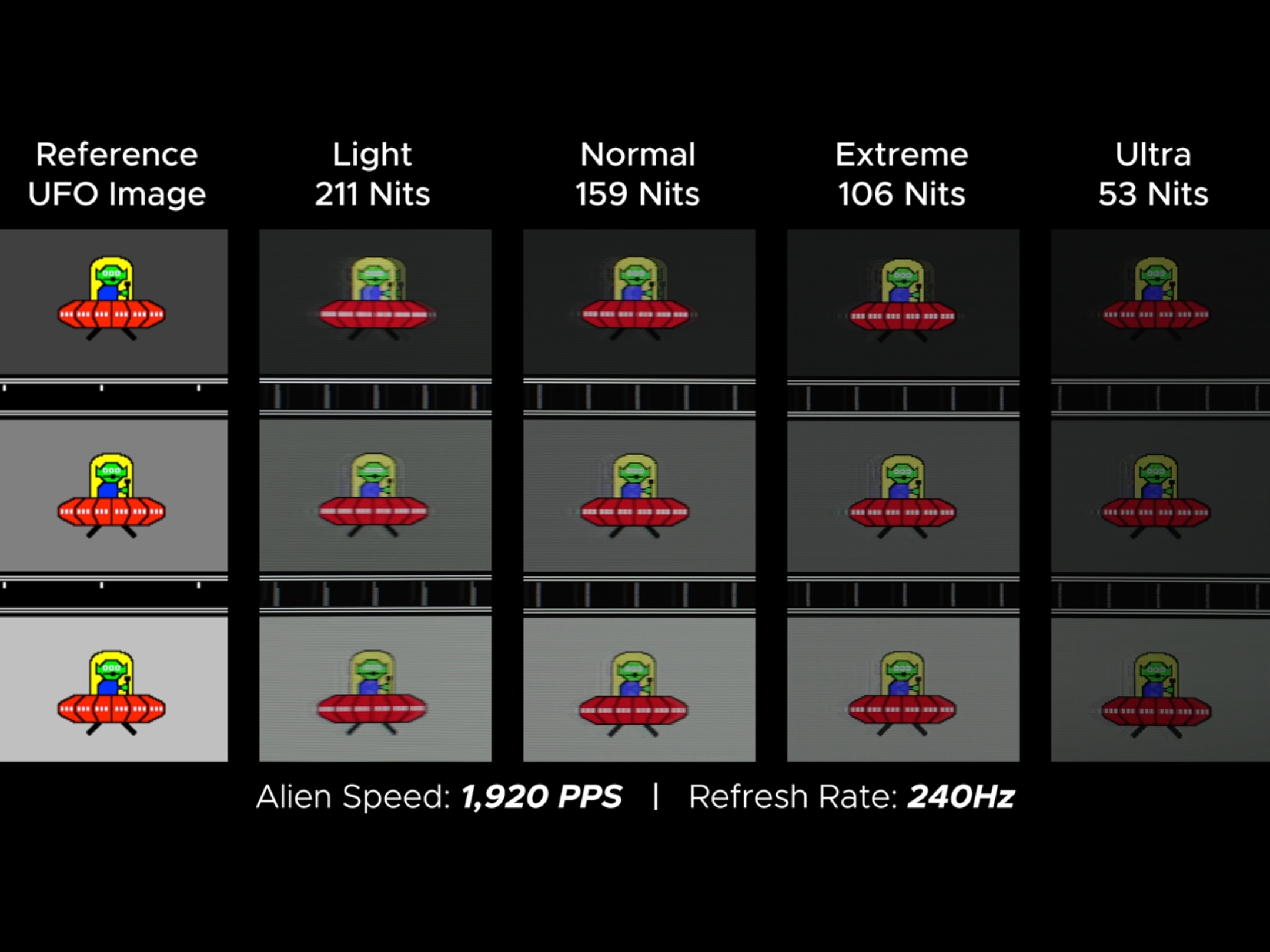

Post by Chief Blur Buster » 04 Dec 2021, 21:15
antiblur wrote: ↑
04 Dec 2021, 03:59
review: https://www.youtube.com/watch?v=TdTwRDa9URo
Embed:
Very good, but the reviewer made one mistake:
You must retune Overdrive Gain between 144Hz and 240Hz. The pursuit camera images for 240Hz can be much better. “35” for Overdrive Gain is too low for 240Hz on XG2431, and adds more crosstalk. 35 is good for 144Hz but way too low for 240Hz.
I should add the caveat that Light adds more crosstalk to top/bottom edges. If you see www.testufo.com/crosstalk when adjusting between Ultra / Extreme / Normal / Light … the crosstalk becomes worse at top/bottom edges the brighter you get.
I would suggest reviewers test both a Light and a Normal/Extreme setting — it makes a huge difference in strobe quality.
This is what 240Hz looks like when properly re-tuned
(courtesy forum member teo who's posting great pursuit camera images here):

Did some testing myself fine-tuning the OD gain and pulse phase and honestly on 20 pulse width(not bright but enough to see comfortably),15-20 pulse phase and 35 OD is the best. Increase OD any higher will cause purple corona artifact behind the ufo especially visible on 1920 pps, middle grey. On 45 OD 2nd crosstalk gets bluer(hard to spot). On 55OD both 1st and 2nd crosstalk gets bluer(easy to spot). Hence I've decided on 35. You guys with the xg2431 can test it yourself if anyone can get a better-tuned setting please share it. I do agree that 35 might be low but not too low as 35-45 doesn't really make that much of a difference and small side effects starts to appear, but once you get to the 45-55 region the side effects definitely starts to outweigh the positives.

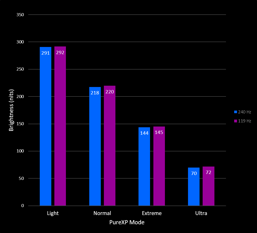

Seems the XG2431 has dimmer strobing than XG270 by a little bit:
XG2431
https://youtu.be/TdTwRDa9URo
XG270
https://www.aperturegrille.com/reviews/ViewSonicXG270/
Still seems plenty bright to me, maybe I am not as sensitive to dimness. Or maybe the youtube guys measurements are low somehow.
Hello boss, I think this is the question we would like to ask many, what are the "Strobe Utility" settings that you recommend for a 240hz strobe? For overall clarity, is it also necessary to set a correct value of contrast and black stabilization? If so, how much?

What’s the brightness loss like though? Based on Bijan’s video it looks like to actually be able to achieve XL2546K levels of blur reduction it loses a lot of brightness, in some cases rendering it unusable. Is that accurate? The main thing stopping me from buying a pair of these still is I can’t tell how consistently functional the blur reduction would be.
Its best strobed IPS you can buy right now. Better than Zowie in every way except strobing brightness obviously, and response time difference is negligible. Try to find out how much ∼160 nits (PXP Normal) really is. Idk what monitor you're currently using but I'll do something unreliable and assume its somewhere in between 20-50%. So if u use your monitor at those levels of brightness than no worries. For example I use my VG279QM at 15% (140 nits) all the time, same for my M32Q. I'm even fine going a little lower.
