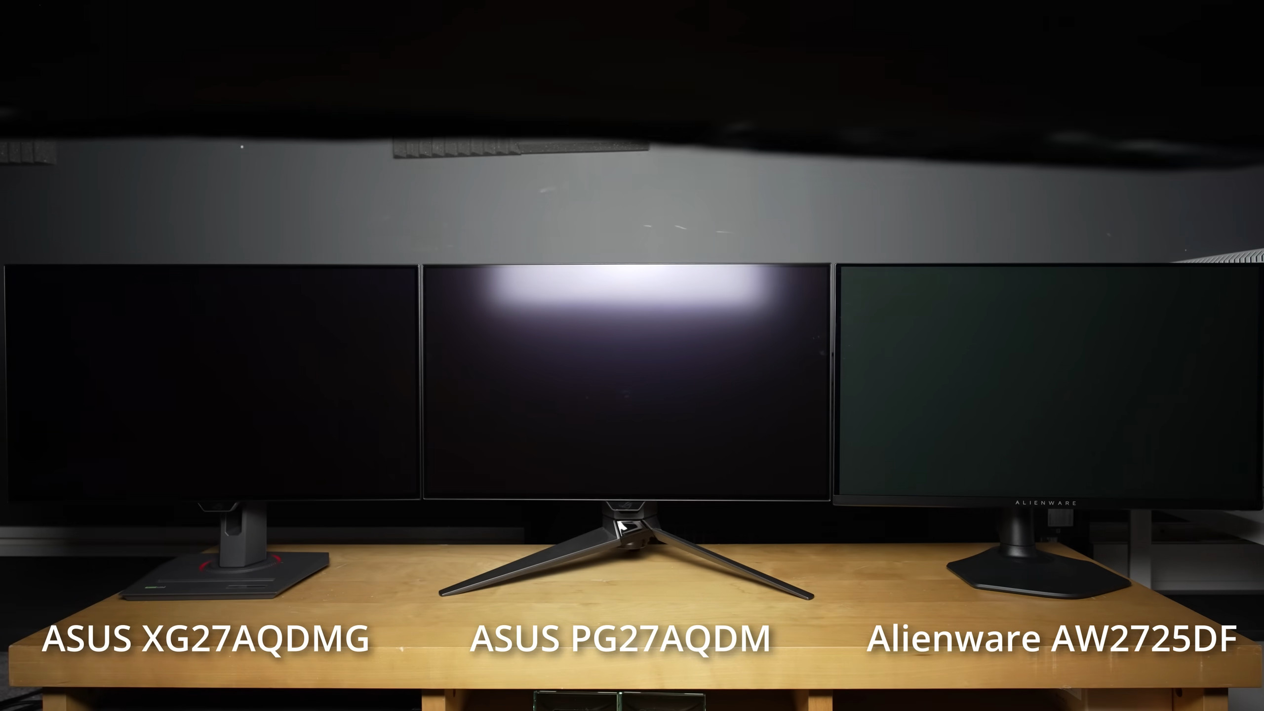

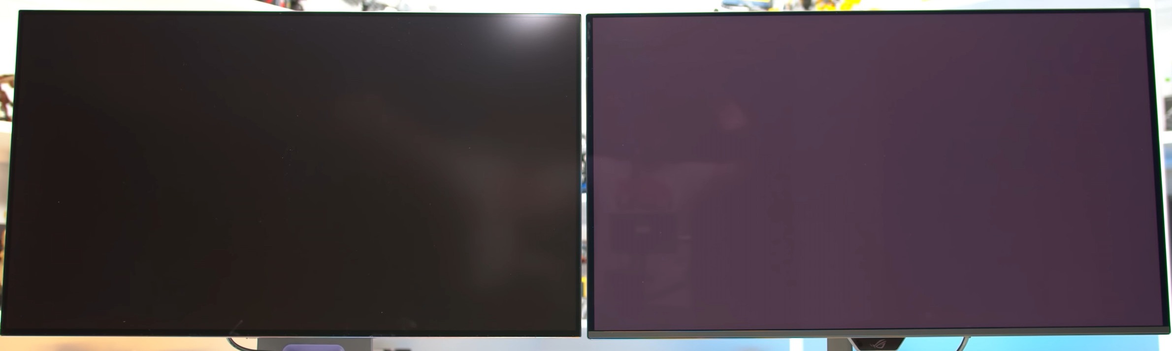

If competitive esports games is your priority, higher Hz is better.
For other games, I would say the Asus has a slight edge in HDR brightness (if you actually like HDR, it's a mixed bag for me because I don't like getting flashbanged in the face,) and it doesn't have raised black levels in brighter rooms. On the other side, the Alienware has a slight edge in HDR colors due the somewhat wider color gamut. However, since you're upgrading from an LCD screen, both of these displays are a huge upgrade when it comes to image quality and the differences are rather minor. If you were to put all three monitors in front of you, the OLEDs would look pretty much the same amount of "better" compared to your LCD.
The only reason why I chose the Asus is the black levels in bright rooms. I use the display in a bright room during the day a lot (and it's mostly sunny here), and I was afraid of this with QD-OLED vs W-OLED:
(Credit: HDTVTest)
(Credit: Monitors Unboxed)
Although this test is very over the top. It's not THAT bright in my room. But still, QD-OLED isn't gonna provide the same level of deep black as a W-OLED in a fully lit room. Also, the W-OLED display in the photo has a matte coating. The XG27AQDMG is mostly glossy, which further improves black levels in bright rooms. It kind of looks like black hole to me. If you ignore the reflections, that is :mrgreen:
