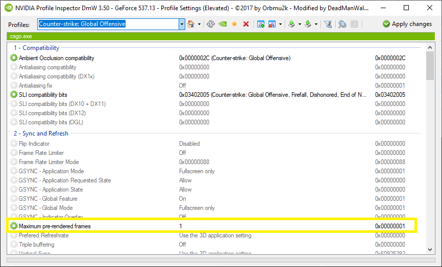

Even after optimization, I've still been seeing horrendous desync in online games. In CSGO there were red errors in console after every desync... and the errors say desync in them. In CS2, the errors are yellow and say time rewinding and interpolation. I tried opening a ticket and Valve closed it saying they don't support console errors. I think I found the problem, but I need other people to test and verify. First, I did the audio changes from the above post. Second, I did that Process Lasso change of I/O priority.

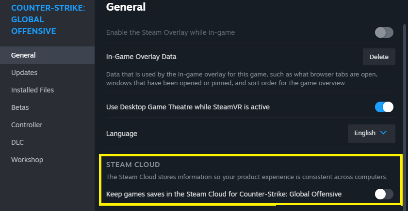

I disabled Steam Cloud for CSGO:

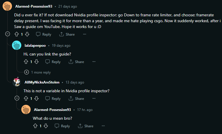

I kept searching online and found this post:
From here:
https://www.reddit.com/r/GlobalOffensiv ... nd_hitreg/

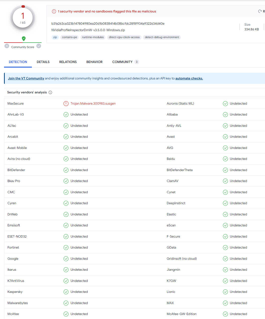

I decided Nvidia Profile Inspector would be worth a shot, however it did get detected as a potential trojan:
I downloaded from a second site, which also had the same issue. Reading around about similar programs, there were many comments that it's likely a false positive so I took the risk and tried it.
Here is what I found:
Like the other commenter said, I couldn't find the setting Alarmed mentioned, but I did find something else.

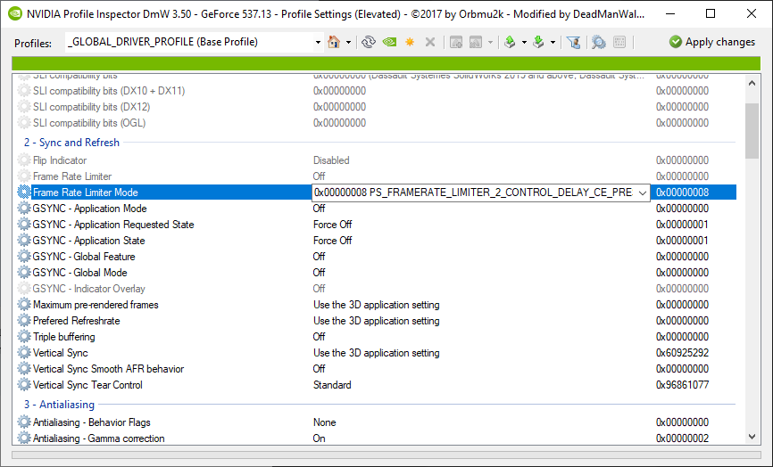

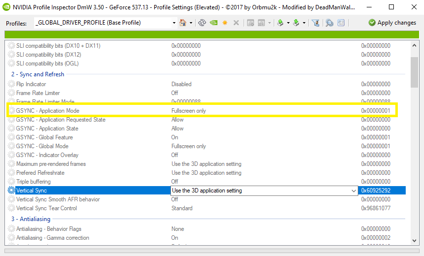

I turned GSYNC off in NVCP, but this setting remained on:
It appears when running fullscreen games, the drivers are trying to use GSYNC. I'm guessing this is connected to Fullscreen Optimizations replacing Fullscreen Exclusive, and Nvidia trying to be clever and use GSYNC instead of VSYNC in the process.
After setting this to Force Off, games seem way more responsive. I still see some time rewinding errors in console but it's like 2-4 at a time instead of 10-20 at a time.
I also looked into the game config files and found some problems:
Setting max pre-rendered frames to 1, also known as Ultra Low Latency Mode, can cripple 2D performance. Nvidia drivers appear to force this on for CSGO, even when it's off in NVCP. CS2 is set to Use the 3D Application Setting. See this post for the benchmarks I found using NULL: viewtopic.php?f=10&t=11711
Here is what it looks like when GSYNC is actually off: (also, found the frame delay present setting after disabling GSYNC)
I closed and reopened the Profile Inspector and the Frame Rate Limiter mode lost its setting, and frame delay present option disappeared again. It doesn't seem to save any changes to this variable.
One more thing... After manually disabling GSYNC in NPI, my monitor remained in GSYNC mode. I had to go into NVCP, turn GSYNC on and back off.

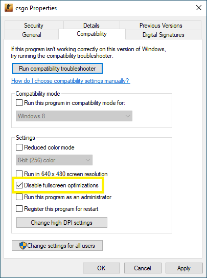

I disabled fullscreen optimization and it appears to be what was causing the desync. However, I have to wait until peak hours to verify.
I was able to verify the desync issue returned again.
