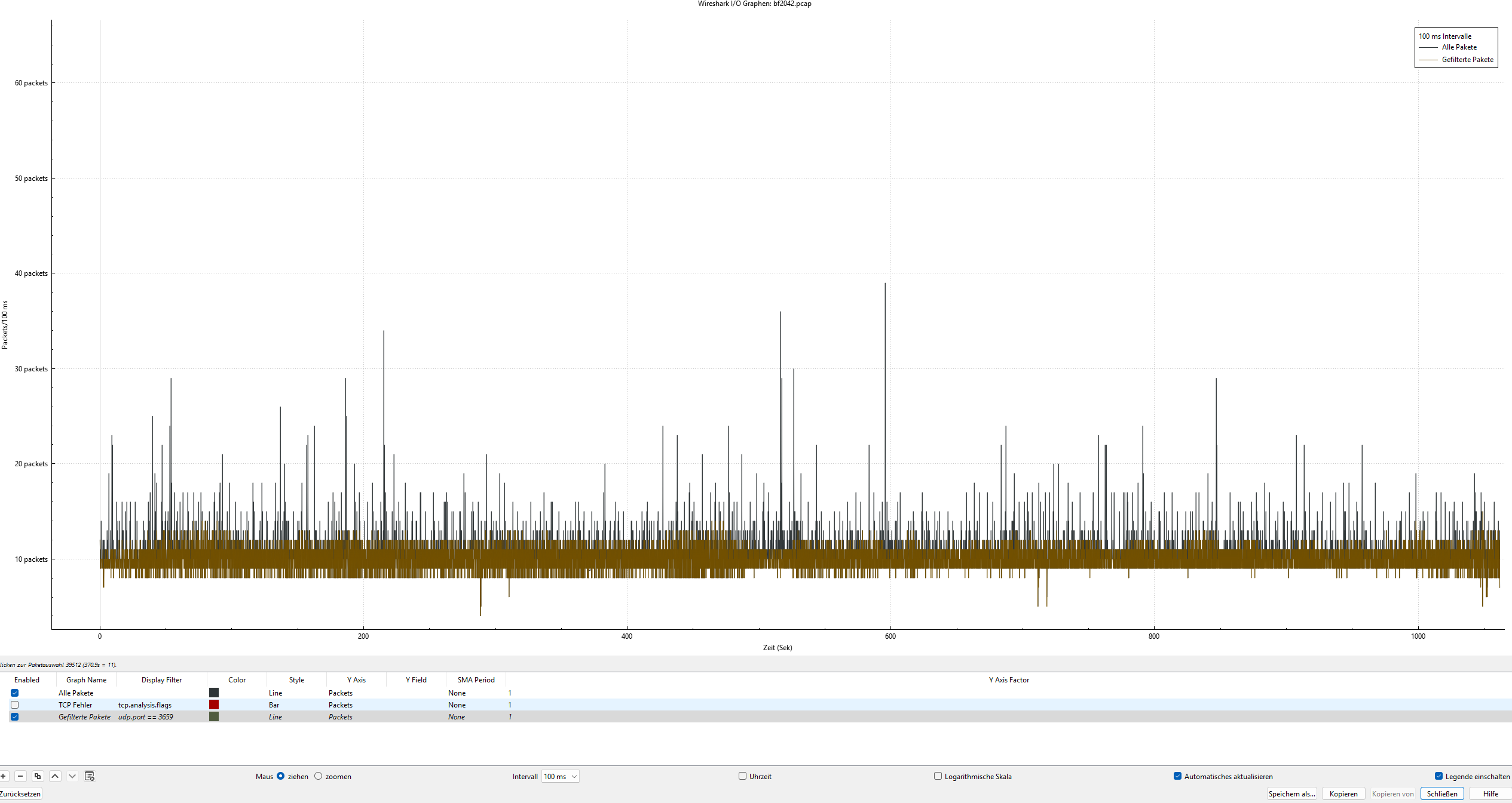

I found the error. My FritzBox ignores UDP data traffic. :roll:
I have now recorded it with “RawCap.exe”.
Screenshot (29).png (256.61 KiB) Viewed 1753 times
I can't interpret the values?
Screenshot (36).png (123.37 KiB) Viewed 1749 times

Post by LaggyTyp » 23 Jul 2025, 07:59
BF2042-Gameplay (Normal)
Screenshot (36).png (123.37 KiB) Viewed 1729 times
BF2042-Gameplay (+70ms Outbound-Ping)
Screenshot (38).png (106.21 KiB) Viewed 1729 times
Can someone rate this for me?
