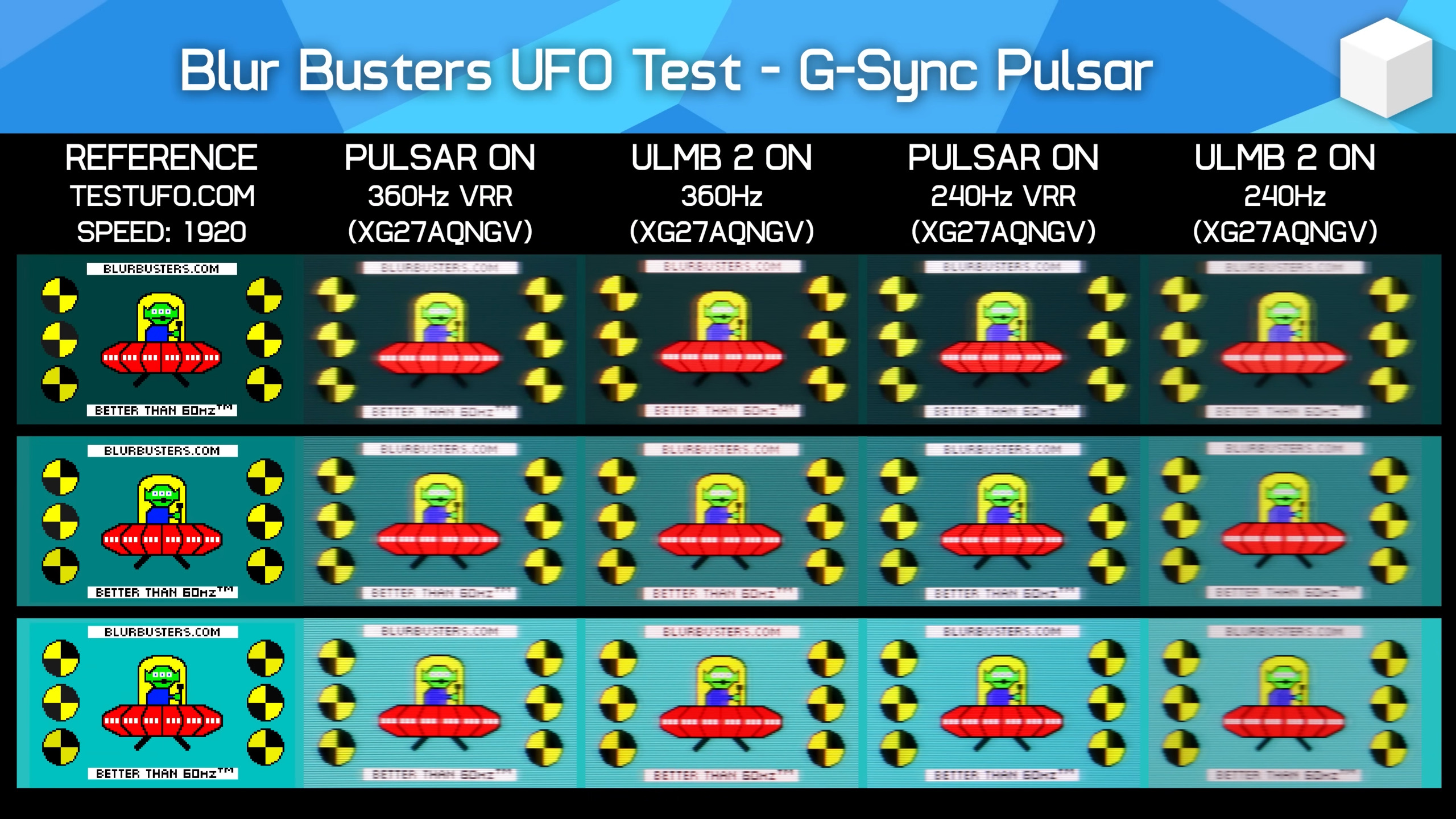

Damn, I missed new ULMB 2 shots from MUB. For some reason they appear to be using the compensation pulse for standard ULMB 2 as well. It's either that or speeds on some of these shots are not 1920 px/sec.
MUB Pulsar vs ULMB 2026 UFOs.jpg (857.02 KiB) Viewed 5072 times
Also why not call it ULMB 3? It differs more from ULMB 2 than ULMB 2 did from ULMB 1 anyways.
