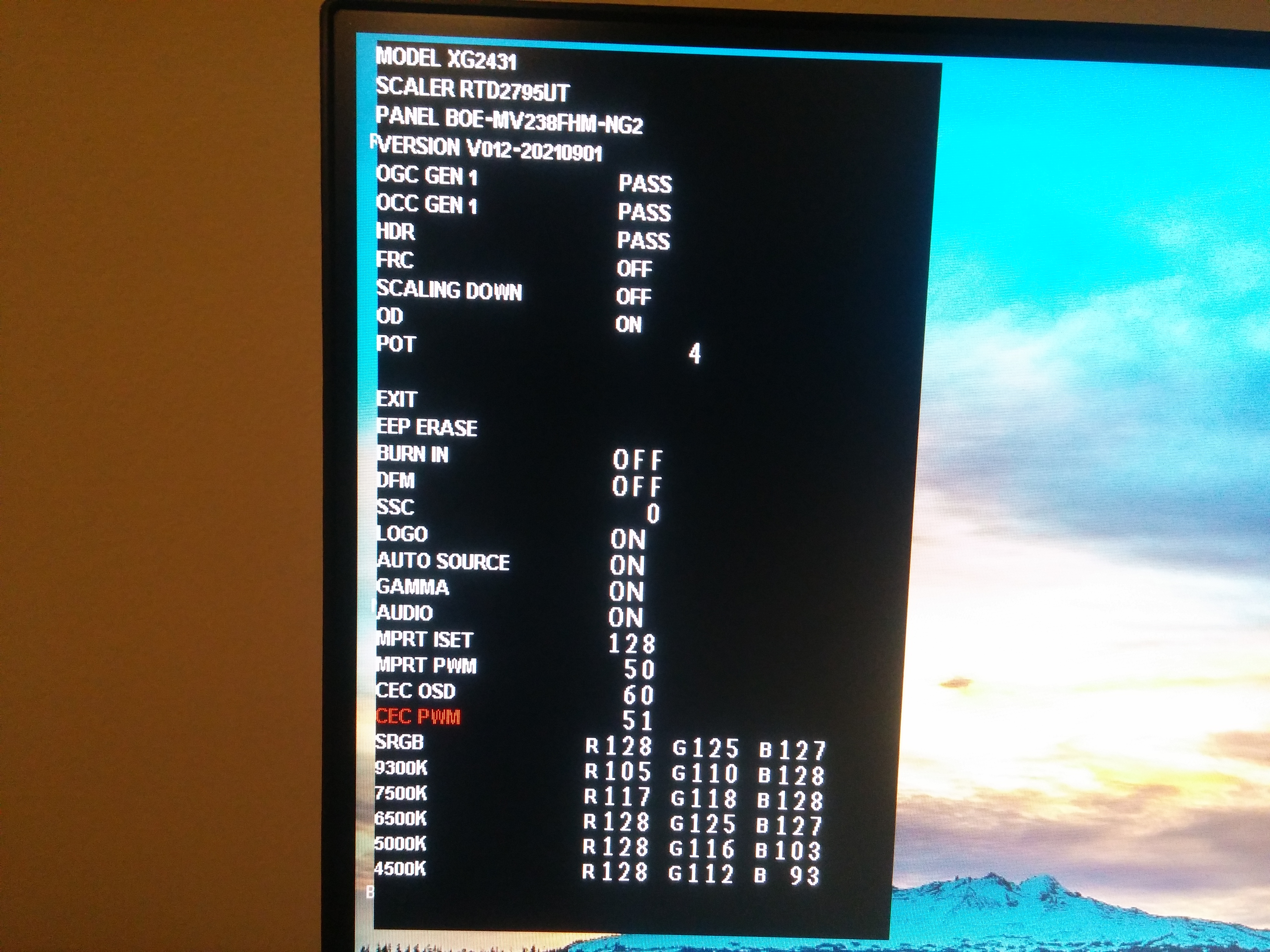

Does anyone know how to access the service menu on this XG2431? Mine arrived today with the factory seal on the box broken. If the monitor was used before, I wanna check for how long.
Try turning the monitor off first. Hold the Menu button and turn the monitor on while you keep holding the menu button. Pressing the menu button again should pop up the service menu (at least this is how it's done on older Viewsonic models)
I found how to access the service menu. I had to press and hold the middle menu button (There are 5 menu buttons). Unfortunately, there is no indication of how long the backlight has been running.
Nice, a panel confirmation. XG2431 uses BOE MV238FHM-NG2. Same as AOC 24G2ZU.
Those are some interesting settings to play around in there.
Why was Chief claiming that the Viewsonic has a Innolux panel instead? Always thought the XG2431 had a different panel compared to the rest of the 23.8" 240hz monitors.
BOE and Innolux aren't related iirc? Or has Viewsonic changed up the panel between newer / older units? We need more confirmations!
If this is a 6 bit +Hi-FRC monitor, then why is FRC turned off?
Could that be causing the eyestrain some people are having?
What happens if you turn it on?
I can't turn it on. https://streamable.com/pybm3i
This monitor causes me eyestrain too. The 1st time i used the monitor, I blamed the eyestrain i got on normal tiredness. Today is my second time using the monitor and after spending those few minutes recording that video, I immediately got eyestrain. It's not tiredness cause i literally just woke up and i was feeling great before using the monitor.
Chief? Any word about this?
I can't tag him.
What happens if you turn on "burn in" and then re-enter the factory menu? Do you have access to those options afterwards?
It seems strange that you have no access to the FRC or Overdrive (OD) setting there.
