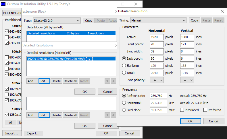

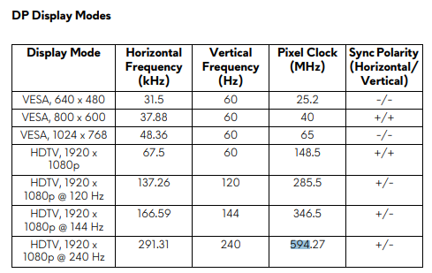

July 31 2022 - Original Post :
The Alienware AW2518HF monitor ships with the incorrect monitor timings which causes frameskipping and terrible ghosting even with no overdrive. The manual specifications do not specify what the proper monitor timings should be other than the horizontal/vertical frequencies and pixel clock totals. The default EDID CTA-861 extension block type doesn't allow for a front porch above a value of 63, so for some reason dell compensated that by increasing the back porch value to 15 (not sure why). Switching the extension block type to DisplayID 2.0 and changing the vertical values to fit CVT-RB2 vertical standards (while keeping horizontal values the same) gave me the exact H/V frequencies and specified pixel clock as described in the manual specifications. Testing this in-game the issue is completely fixed everything with no tearing or visible ghosting on the highest overdrive settings. The correct timings are shown in the CRU screenshot.

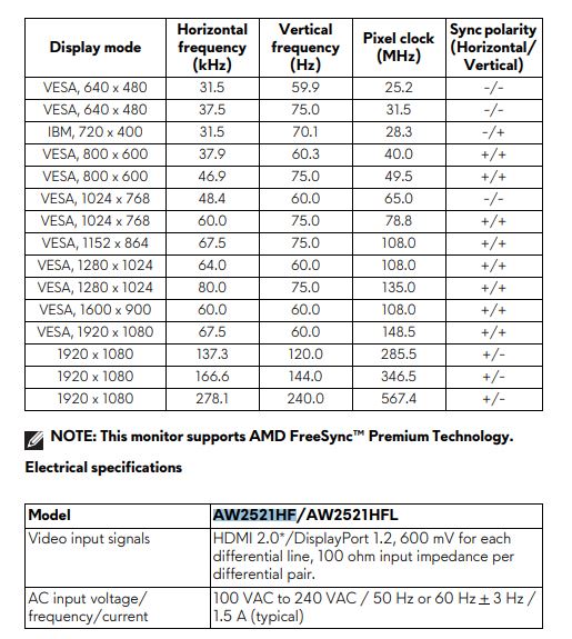

Strangely enough, the AW2521HF product manual specifications lists the same horizontal/vertical frequencies and pixel clock timings that were incorrectly shipped with the AW2518HF (possibly due to a Dell test employee noticing that the manual specifications didn't match with the actual values and they may have just negligently made a correction on the document in order to save costs within the production pipeline).
aw2521hf product specifciation for pixel clocks and horizontal vertical frequencies.jpg
aw2521hf product specifciation for pixel clocks and horizontal vertical frequencies.jpg (84.51 KiB) Viewed 25686 times
AW2518HF product specifciation for pixel clocks and horizontal vertical frequencies.png
AW2518HF product specifciation for pixel clocks and horizontal vertical frequencies.png (46.47 KiB) Viewed 25686 times
AW2518HF CRU correct settings.png (51.81 KiB) Viewed 25686 times
