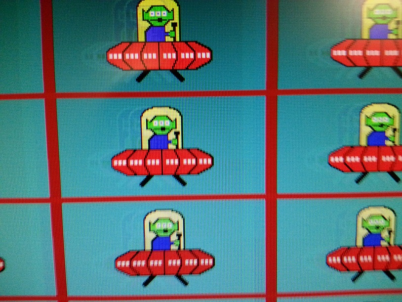

Did UFO test and got these results...middle of screen...
UFO Test.jpg (235.83 KiB) Viewed 9745 times

Guess it really doesn't come out that well in that picture that I resized from 3.1MB to 230kb :(
Anyways, ghosting is clearly seen via space ships. The monitor is also hellishly dark when compared to the Asus one although everything says you can go brighter with BenQ vs Lighstrobe but I'm just not getting these results :(

That's how it's supposed to be.
What you need to do is to actually play a game. 2D simply exaggerates that type of ghosting because of the gray and sharp transitions. You don't usually see transitions like that as often in usual gaming scenes.
If you run the Benq in lightboost mode (if you have an NVidia card and a way to enable LB on the benq; you can use the "3d vision emulator" and the INF override btw), you will see that the type of trail ghosting is MUCH reduced, and the image looks much better, EXCEPT at the bottom of the screen (where it looks quite bad); actually looks worse than with BBR and the V1502 tweak.
Lightboost uses accelerated scanout and per line overdrive, so the image overall looks much cleaner in motion, but it still looks worse on the Benq than on the Asus panels (with their superior tracefree RTC).

blakedc wrote:Anyways, ghosting is clearly seen via space ships.
That inverse ghosting almost unavoidable. Even Lightboost has that, but to a much lesser extent. You have some options:
1- Deal with it :P . While playing games it isn't as bad as in motion tests.
2- Turn AMA off, if you prefer ghosting instead of inverse ghosting. It helps in some situations where inverse ghosting was ugly, but in others you'll notice the slower response time of colors.
3- If you have a 3D Vision 2 kit, use Lightboost. It has worse colors and it's a lot less tweakable. Use this if not having overdrive artifacts is your number one priority.
4- Again, if you have a 3D Vision 2 kit, there's a special trick. Enabling Lightboost and then disabling it (going to a normal resolution with BenQ MBR), the monitor enters a state in which it's using MBR but it's like it's using some Lighboost internal settings. Ghosting is different. If you disable and then enable MBR, the monitor will return to normal. In some situations, it imitates correctly the lack of inverse ghosting that Lighboost has, but sometimes colors are weird in movement in the lower part of the screen (it also happens in LB, but it's a lot less noticeable). In my opinion, it looks good in Bioshock Infinite and Borderlands 2, for example.
