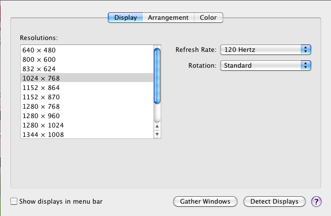

Here is an image of being able to run at 120 Hz on the OS X side:
HP P1230 on OS X Snow Leopard.jpg (79.98 KiB) Viewed 8783 times
