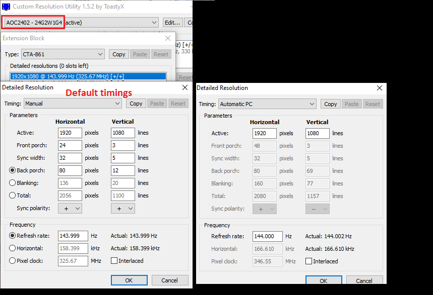

Do you use Overdrive boost or MBR 20? From my settings here /viewtopic.php?f=4&t=11677 it's better than 144hz. Do you use 1000hz mouse?
Probably try to use CVT-RB timing / Default, but only change the Vertical Total (120hz stopped at 1405, 144hz stopped at 1171)

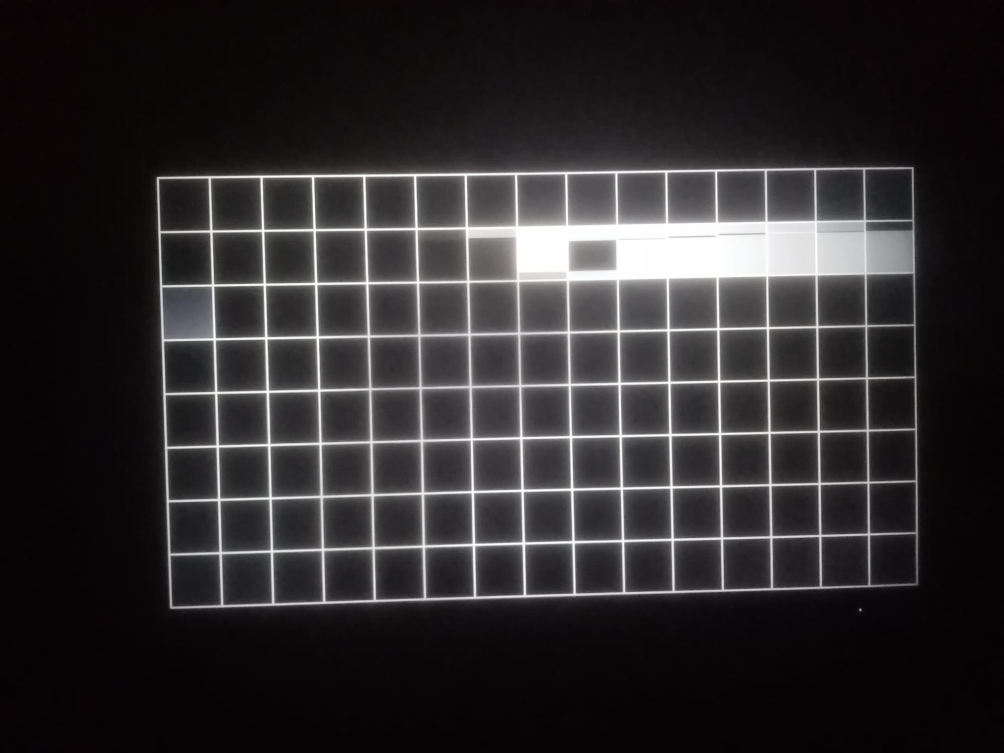

amorou
- Posts: 248
- Joined: 29 Aug 2022, 18:46
Re: Monitor's timings effects visual fluidity , need opinions
Is that just frameskipping , or smth more ?Chief Blur Buster wrote: ↑10 Mar 2023, 12:13ALERT: My Reply is Fact, Not Opinion
