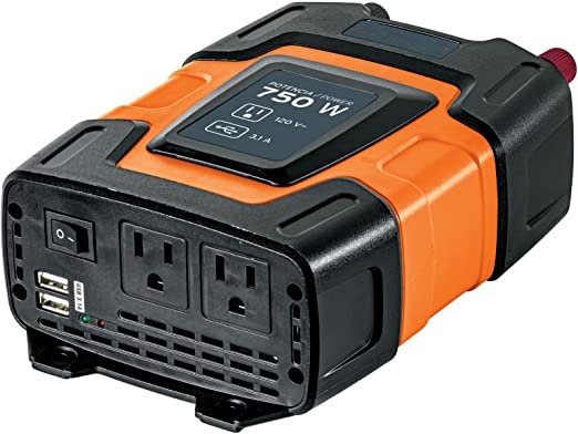

SEARCH TERM: "12 volt 750 watt inverter" on your amazon/ebay/favorite site
Make sure your brand is a true sinewave inverter that preserves the sinewave even at high power loads; check the reviews.
Use M8 DC power cables to connect battery to inverter.
Then plug in your PC/monitor/router to the inverter.
Then you can power an average RTX-powered desktop tower gaming PC rig for about 2.5 to 3 hours, offgrid.

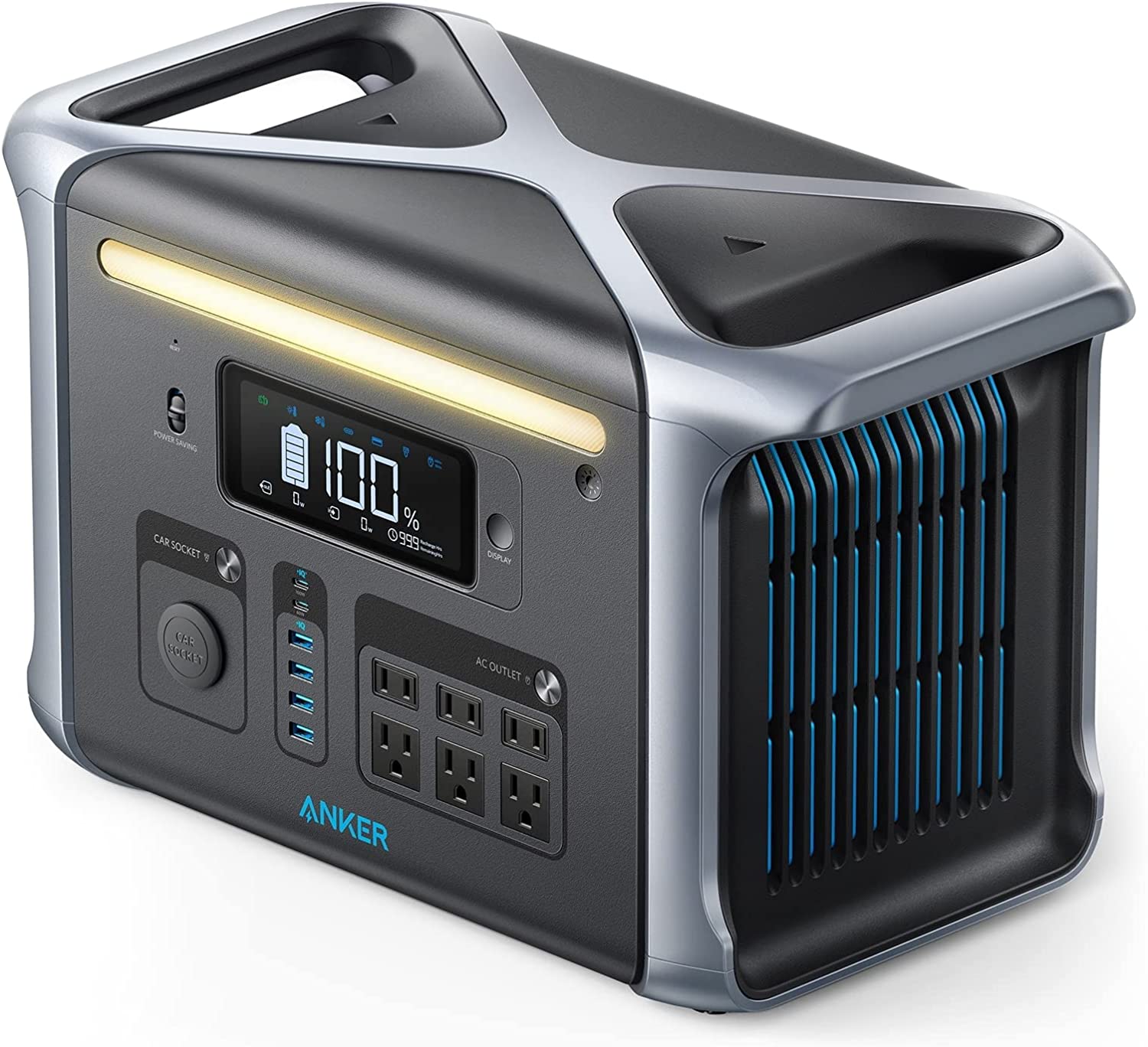

If you have more money, just buy a prebuilt battery with inverter built in. Like a Jackery Power Station 1000 or 2000. Or Anker Model 757. Many clones available. Or one of the new brands that just became available. Beer-cooler sized battery generators.
SEARCH TERM: "portable power station"
Look for something with quadruple-digit watt-hours. Only those quadruple-digit watt hours will work to power a gaming PC offgrid usably long enough. Stick to good major brands only, since these may use the higher-explosion-risk but lighter lithium batteries.
Remember, there's two major types of lithium batteries...
The major brands will generally use trusted lithium-cobalt-maganese batteries (e.g. US/Japan manufactured lithium batteries). If you buy lithium batteries directly from China, only stick to BMS-protected lithium-iron batteries. (The safety of lithium-iron compensates for going generic)

At a certain cost point, it's cheaper to just buy a giant LiFePo4 battery (e.g. cheap 12.8V 200AH with built-in BMS + get a cheap inverter) to battery-power your 500 watt gaming rig. And it usually fixes more external bad-electricity problems than even a good UPS will.
Basically build your dream UPS of clean electricity from scratch, and then unplug from your dirty power grid.
You can buy a large Jackery Power Station (or clone), many exist for between $1K-$3K all built. Or cobble together a 1000-3000 watt power station from scratch via YouTube videos. Google "how to build a lithium power station" if you can't afford a Jackery but can afford buiding your DIY power station $300-$600 kilowatt-hour-plus kilowatt-output-league lithium battery with built in battery management system (BMS) + charger + external high-quality inverter.
USD $279.99 battery + USD $59.99 inverter = Power Gaming Rig for 3 hours
You're your own power company for 2-3 hours, forget the dirty electricity stuff, forget wasting time troubleshooting...
(Many brands available, not just this one)
(12.8V 100aH = 12.8 x 100 = 1.28 kilowatt-hour capacity = can sustain 400 watts for 3 hours)
SEARCH TERM: "12 volt 100 ah lithium iron battery" on your amazon/ebay/favorite site
Sorry for this but, have one question sir, https://www.amazon.es/EF-DELTA-Pro-ampl ... uage=en_GB
This will work if can affordable? Or dont have an inverter in it. Thanks!!!
yes it will, it does have an inverter. make sure to not use ethernet or any other external device connected to the pc while using the pc
make sure to unplug the charger when using your pc. use wifi tethering or dongle
