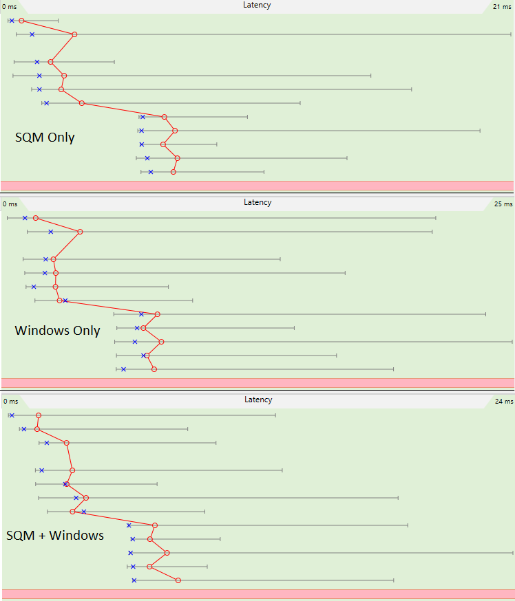

Here are some UDP ping test results while running the bufferbloat test:
SQM Only means autotuninglevel=normal with SQM on.
Windows Only means autotuninglevel=disabled with SQM off.
Here is the result with no SQM and autotuninglevel=normal:

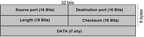

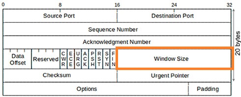

1. BufferBloat tests are for TCP, most games use UDP. TCP can influence UDP network/system performance, load etc.
2. "netsh int tcp set global autotuninglevel=disabled" setting manipulates TCP window size behavior
3. UDP doesn't have a window size.
4. UDP is typically a stateless protocol, send the packet and hope it gets there (no guarantee). TCP validates packets are received, otherwise they can be resent.
