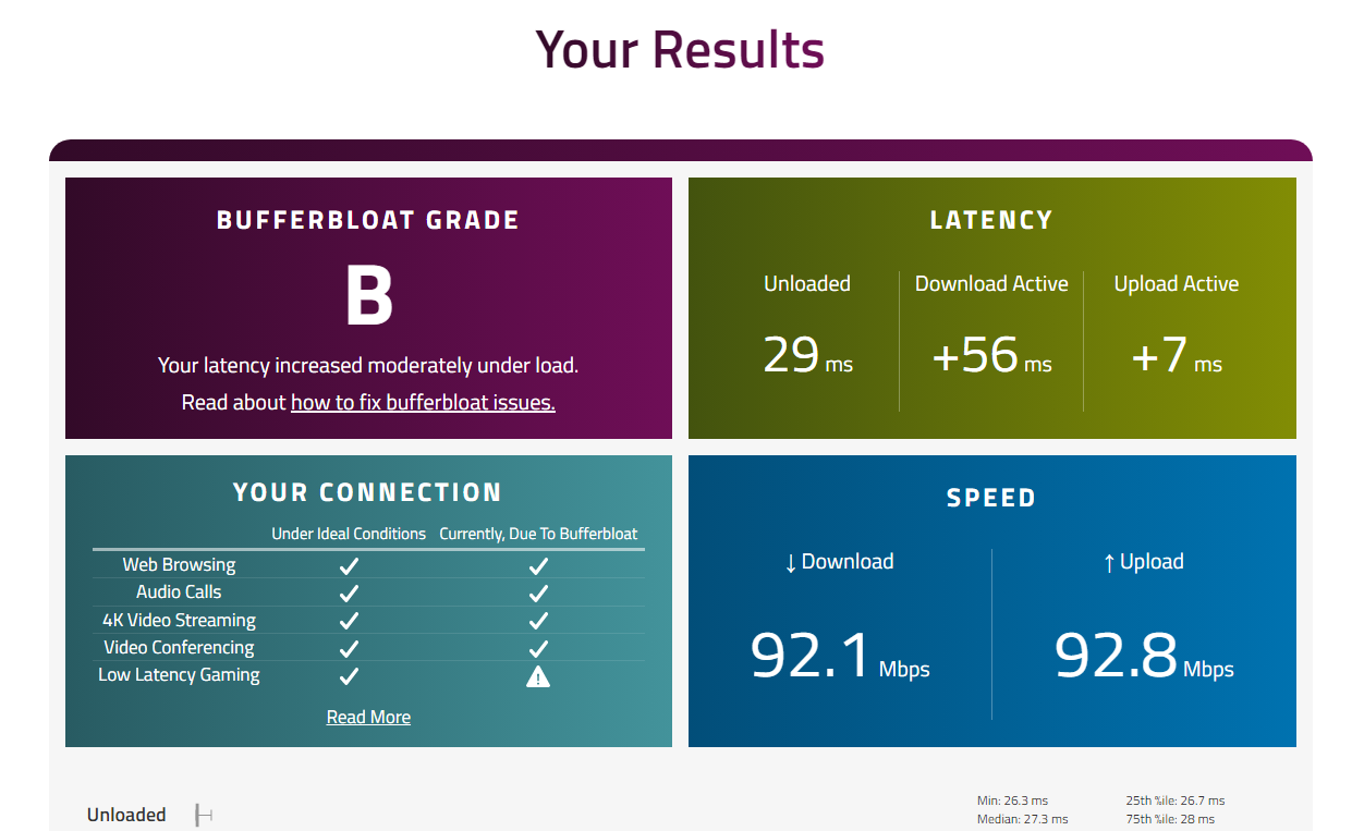

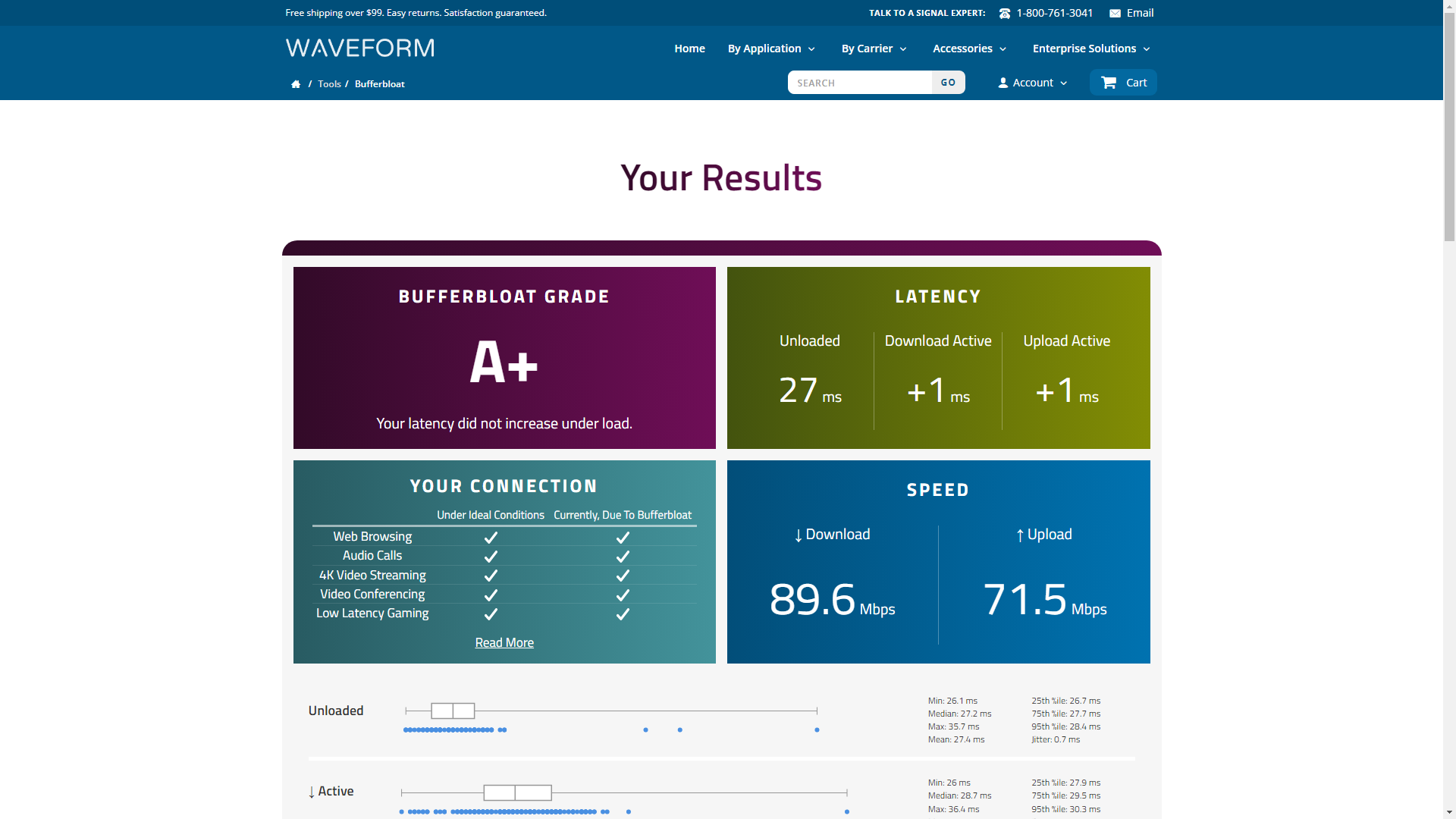

in this thread you can discuss about any network settings, and how you can reduce the latency on this test:
https://www.waveform.com/tools/bufferbloat
what am i doing?
the first thing I did was tidy up my MTU size (1500 by def), for me it's 1480 for some reason.
then I enter this command:
netsh int tcp set global autotuninglevel=disabled
(powershell)
This two options you can set in TCPoptimizer
After that my latency is reduced.
idk, maybe that work not like that, but it working.
after/before

Based on the screenshots, it looks like you traded a bit of throughput for lower buffer lag. For gaming, I'd say that's an improvement. The bufferbloat generally shows up when the throughput is saturated, as packets start queuing up instead of being transferred "right now".

I found mine to be not fragmenting at 1462 + 28 = 1490 MTU size.
But thank you for the autotuninglevel, this worked wonders!
(Combined effort with network driver tweaks+MTU+autotuninglevel)
