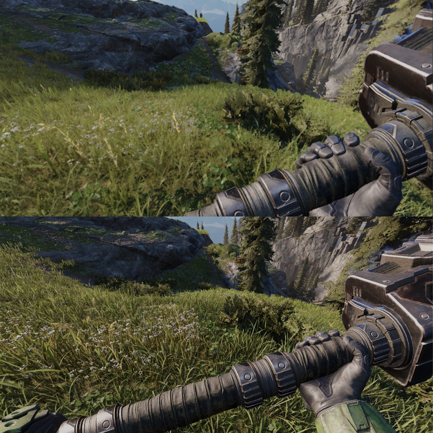

TAA & Persistence Blur
So this forum is dedicated to motion clarity, however it typically only talks about persistence blur (which is very important, and I am very dedicated to solving that issue as well, either via 1000hz panels with async warp or innovations to BFI such as ULMB 2)
However -- there are other issues contributing to poor motion clarity that also need addressed such as TAA (temporal anti-aliasing) which is an anti-aliasing solutions that uses past frame information to better detect what is aliasing and isn't. The problem is keeping this past frame information can lead to ghosting and blurring in motion.
It's sort of funny how it mirrors the issue of persistence blur, where the ghosting is like crosstalk or response times (overshoot), and the blur aspect is from keeping past frame information like a sample and hold display keeping the image on screen instead of strobing it.
Both result in significant image quality issues, but obviously they do so to attain other aspects of quality such as in BFI's case - flicker free, brighter image, and TAA's goal to reduce aliasing even further than other anti-aliasing methods. It really comes down to an individuals own preference, which will vary from display to display (some will have worse BFI implementations than others) and game to game (some games may have too much aliasing with TAA off, some games won't. Most games will also have very blurry TAA but a select few may actually put the time into it to make it look good in motion)
The reason this is also an issue is because more and more games these days are not providing an off/non-temporal option for anti-aliasing, if they provide any option at all its always "Low" and "High" (MW3, Battlefield 2042, Halo Infinite, 95% of UE5 games, etc) which means TAA is being forced onto people and is why modern gaming is so blurry and soft. It would be nice to achieve the following
Solutions
1) Advocate for non-temporal options to be provided like SMAA, or even just off, having an alternative solution would be better but the ultimate goal is to not have it forced onto people
2) Provide developer resources and knowledge on the best ways to correctly implement TAA to reduce blurring whether it's in stationary or in motion (if you know, if not I have a lot of documentation & knowledge on that)
3) Advocate for developers to expose TAA options in game so people can find their own balance of blur & anti-aliasing, if TAA is important for their render pipeline and they don't wish to put work into getting the game to look pretty with it off. This would include exposing things like "Current Frame Weight", the "Sample Count", the "TAA History Reprojection", and "Filter Size" to the user
Theirs a subreddit dedicated to the topic called r/****TAA (which has a vulgar name that triggers a defensive response, which I do not like) but theirs also another one that encompasses both issues (persistence blur and TAA) with a more PG name called r/MotionClarity if you need more information or would like to help bring awareness I recommend joining but it would be cool if we could discuss that here more, is the reason were not because we'd like to focus on one issue at a time and leave the other to other people? Is it because of ignorance of the issue? Either way thanks for reading
Here's a informative video with more examples & detailed information/solutions if you want to learn more https://youtu.be/YEtX_Z7zZSY
TAA (Top) vs No TAA (Bottom)

I remember seeing FXAA for the first time and thinking wow, this game looks blurry. Why is it even implemented? SMAA and TAA also make games look blurry, so I just end up disabling anti-aliasing to get the sharpest possible experience.
But there are indeed some games that force it like Alien: Isolation, had to refund that game because it was too blurry. A Plague Tale: Requium is also another game that forces anti-aliasing (not sure if it's TAA or SMAA) but you can disable it via .ini file. For some reason they didn't add an option in the graphics/video menu to disable it.
I've honestly never understood these other anti-aliasing methods. Do people not see how unsharp the quality of everything is? it's borderline trickery that makes you think there's something wrong with your vision. I don't care if they reduce resources, it's the equivalent of lowering render scaling to around 80% to my eyes.
The ONLY decent anti-aliasing method is and was MSAA. It should always be an option in games, but sadly over the past decade MSAA is rarely implemented now.

There's a simple reason; MSAA can't cover the majority of aliasing in deffered-rendered games. It's really only effective on simple geometric edges in traditional forward-rendered games, hence the "need" for temporal forms of AA.
Modern games almost look broken without some form of TAA (shimmering galore), but the side-effect of TAA/DLSS/DLAA (etc) are artifacts like smearing, ghosting, and/or blur, and due to the temporal blending of these reconstructive techniques, it's difficult to balance coverage, sharpness, and artifact levels all at once.

Yes anti-aliasing is tricky, however the answer is quite simple & easier than you think (look at the solution section) TAA can be fine when done right or if you just give the users control over temporal settings, because everyone can find their optimal balance. But doing this requires advocacy and education.
Death Stranding for example has good TAA, and they have public documentation about how they built it and their reasoning behind each decision, it is temporally stable and it doesn't blur much in motion.
TAA is only awful because it's such a dynamic and variable solution that's very easy to mess up, in an industry where crunch is common, developers do the bare minimum because they're burnt out and most people are blissfully unaware it has motion issues to begin with means it's going to get screwed up a lot. Most developers don't even test their TAA in motion.
TAA is not as awful as it seems, and it doesn't have to remain a double edged sword, we shouldn't just throw our hands up in the air and accept it. I'm a game developer and I've been pushing for change on the inside, I just need people on the outside to let them know this is actually something a decent amount of people care about.
