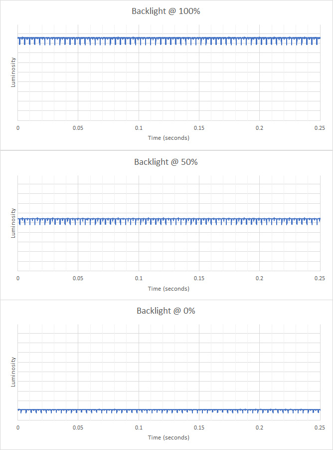

That monitor operates in sync with the refresh rate so for 240hz it flickers every 4.16ms(1/240hz), if you have it at 60hz it would be 16.67ms and so on.
https://tftcentral.co.uk/reviews/asus-r ... d-pg27aqdm
https://www.rtings.com/monitor/reviews/ ... d-pg27aqdm

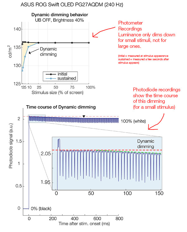

Below you see a plot of the dimming phenomenon from my first question: We notice that small but not large bright stimuli on the ASUS OLED dim rapidly within the first 500 ms by about 5% (or 10 nits).
As the upper plots shows, this does not happen for large stimuli (> 25% of screen area). Importantly, at the luminance level at which these measurements were taken (Brightness setting: 40%), ABL does not happen anymore, that is, the "sustained" luminances (measured after 1 sec or so) are unaffected by how big a stimulus is. I would have expected such a "dynamic dimming" (is there an official name for this?) maybe for large bright stimuli, but not exclusively for small bright stimuli.
A 5% change in luminance for some stimuli (only small ones) is not necessarily a deal-breaker for research use in my field, but it would be helpful to understand where this is coming from, what it depends on, and whether this phenomenon has a name or a technical explanation.
