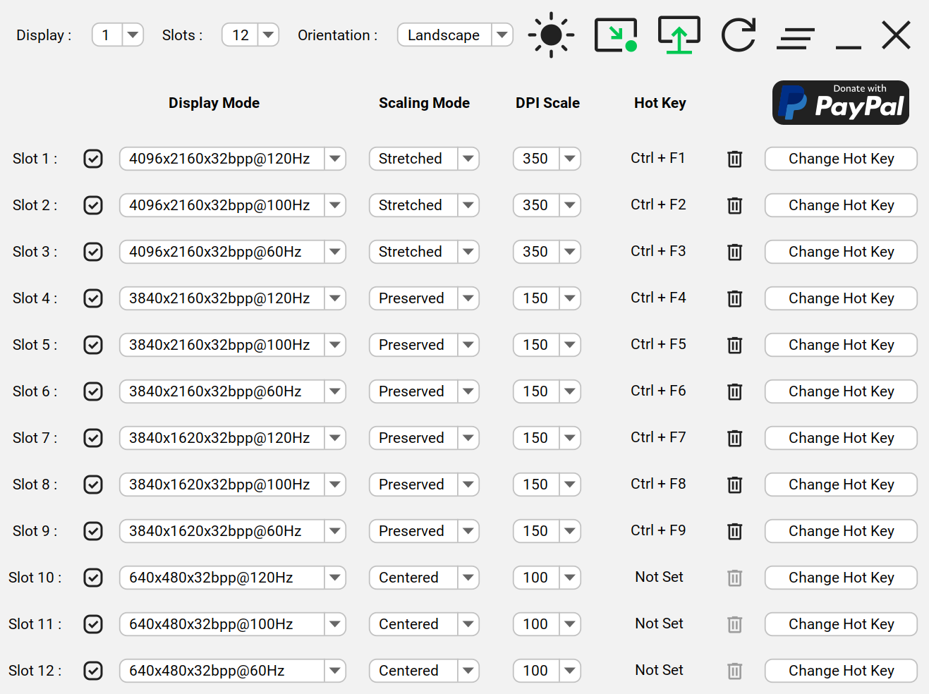

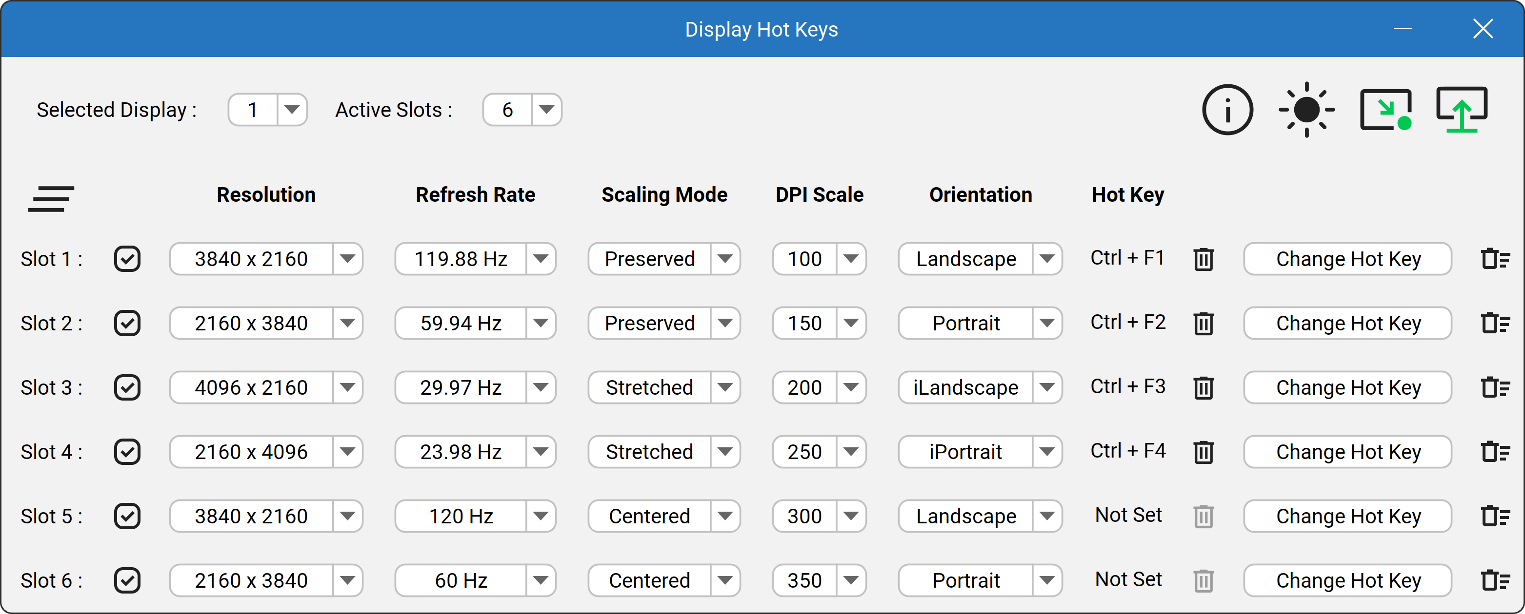

Hello Blur Busters!
This project was created to circumvent the tedious navigation of the Windows settings menus to change display settings. With Display Hot Keys, the display resolution, refresh rate, scaling mode, DPI scale percentage, and orientation can be changed for each connected display with user-defined hot keys.
Common Use Cases
  • Switch refresh rates to quickly enable the Black Frame Insertion or Backlight Strobing capabilities of the display.
  • Easily rotate the display orientation with hot keys.
  • Quickly switch between resolutions with different aspect ratios.
  • Immediately apply a resolution without entering the in-game menus for video game benchmarking purposes.
  • Enlarge or shrink the elements on screen by instantly changing the DPI scale percentage.
  • Instantly set resolution and refresh rate while in a video game if it does not support changing these settings while in-game.
  • Retain your intended display arrangement while changing display resolutions.
  • Change settings for multiple displays at the same time with one hot key press.
Let me know if you have any issues on the GitHub page, and I'll do my best to fix them! Also, if you find this software useful in any way, please consider giving the project a "Star" on the GitHub page and/or donating. Thank you!
Website: https://jon-mil-92.github.io/DisplayHotKeys/
Example Screens
