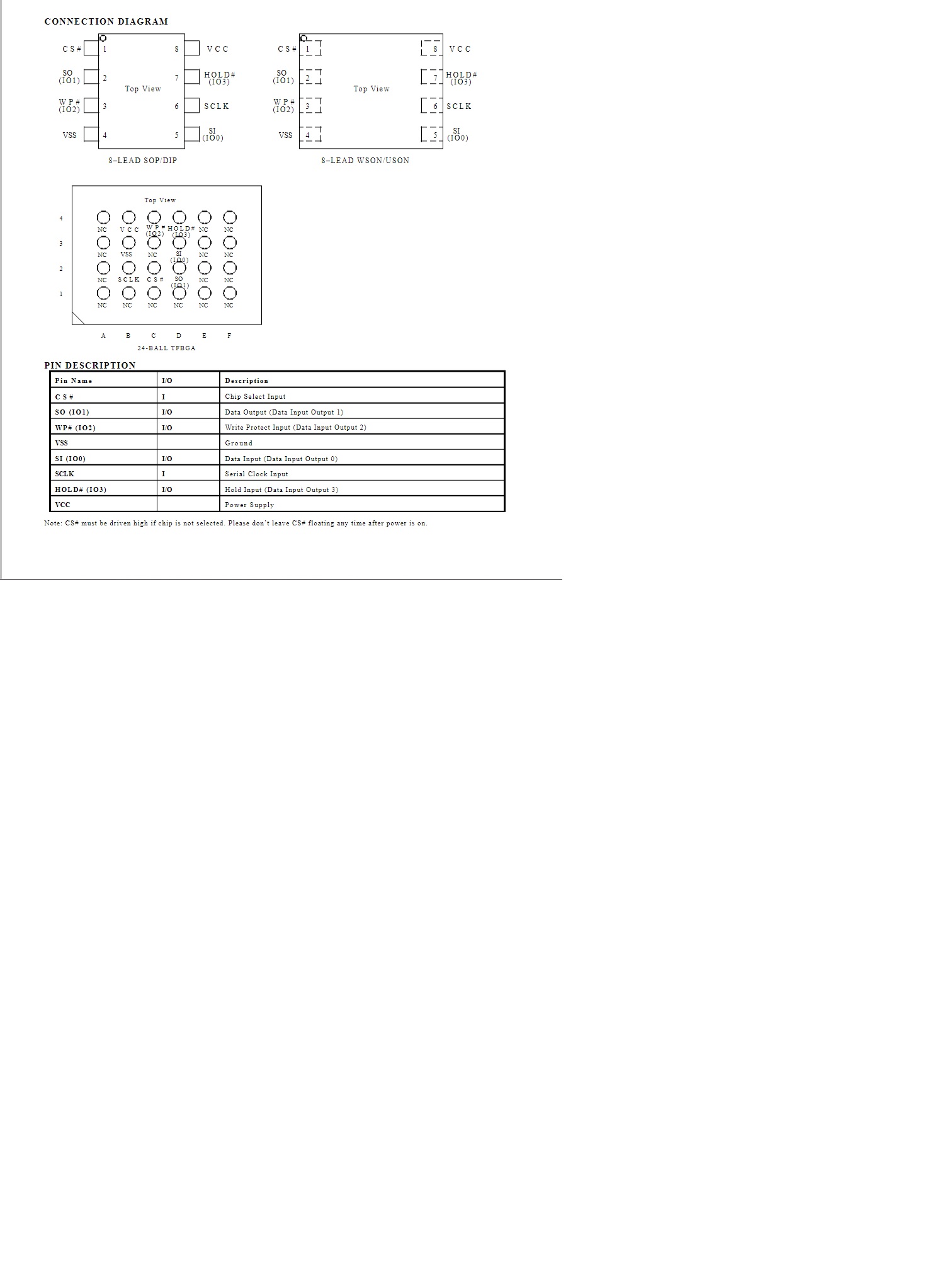

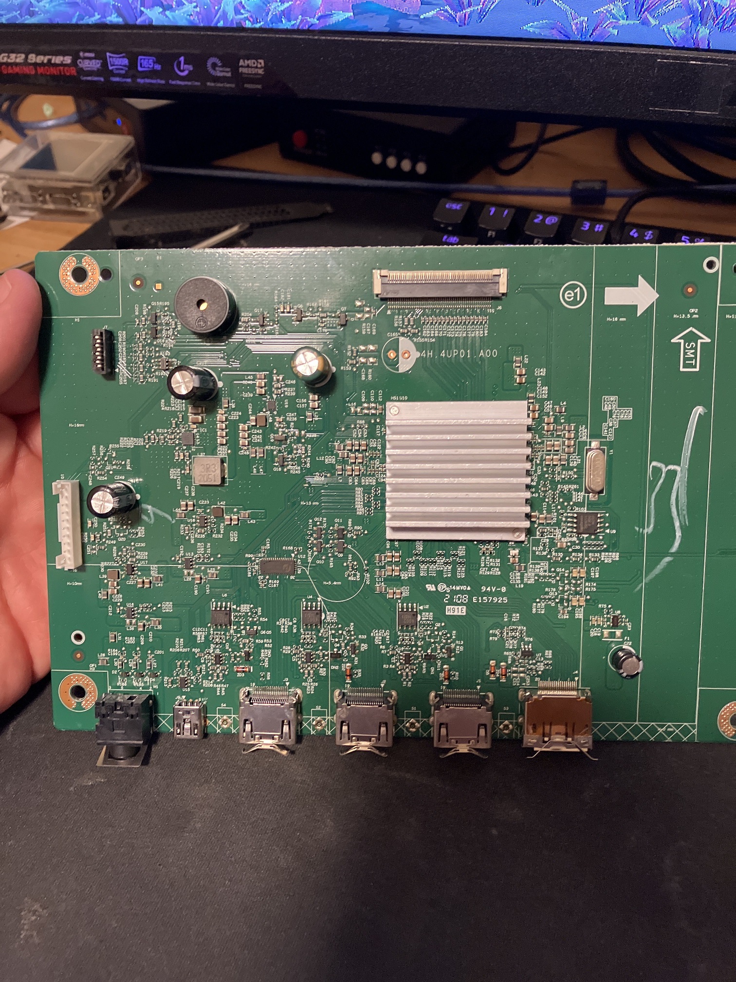

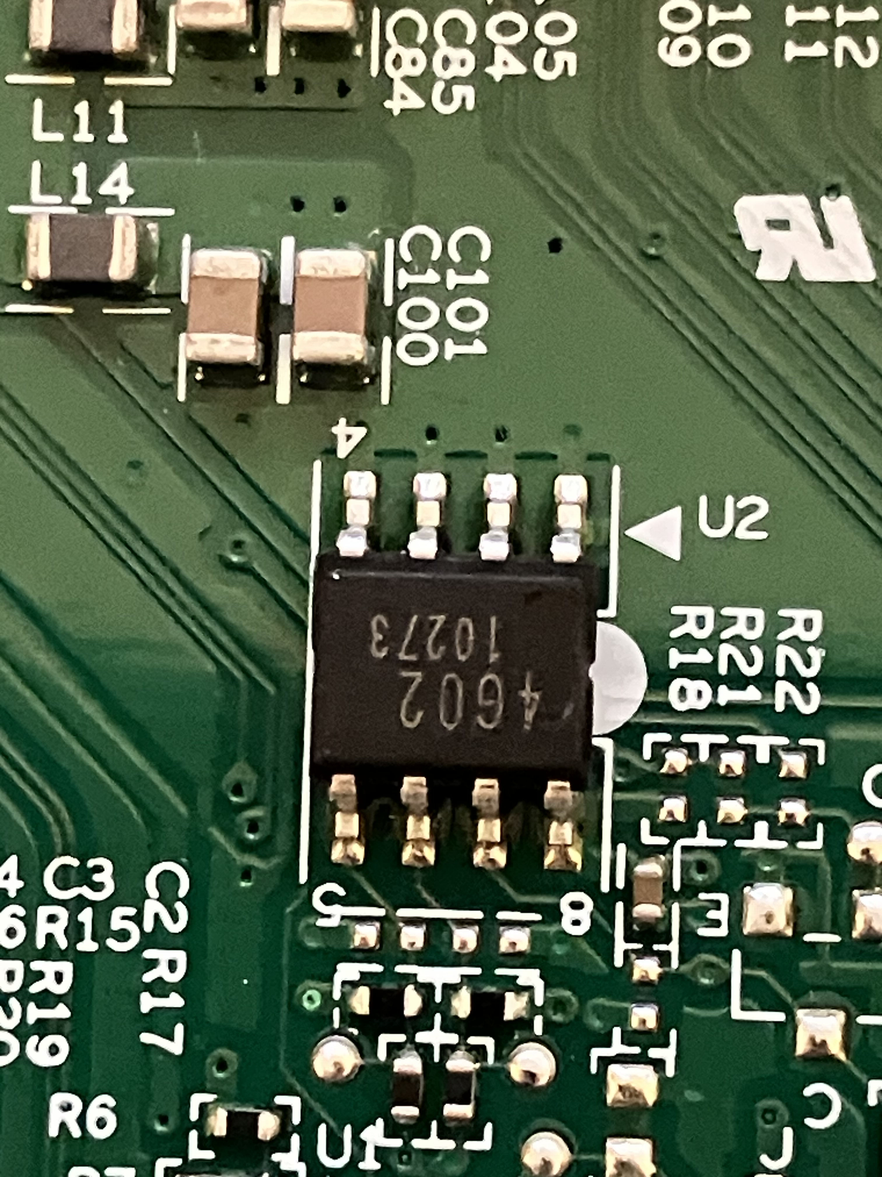

In attempts to write to the EDID of the BenQ XL2546K through both HDMI & DisplayAdapter I get failed to write. I've tried enabling burn-in mode through the monitor, and trying again (no luck). So I start looking into the hardware lightboost mod, and was wondering if that's the same thing that is happening to me. I disassembled the monitor, and found this chip, and the data that goes to said chip. If I cut the the Write Protect Input would that allow me to overwrite the EDID of the monitor?

Well, I cut the leg, monitor works still. But still unable to write to the EDID of the monitor.
So the next question is, is it because i'm using a 4000 series GPU and I need an older one to do this correctly?
