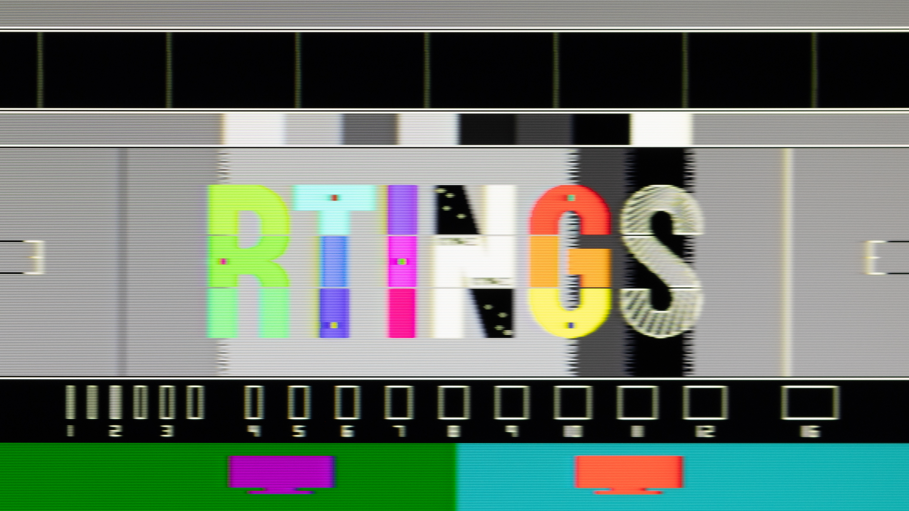

Let's stop fooling ourselves and spreading this EVIL lie that you can't tell the difference between native 500 HZ and Strobing enabled?
The difference is obvious and strobing always wins, also does anybody know how hard it is to get 500 FPS in games?
STROBED IPS 120 HZ 120 FPS XG2431 Blur Buster 2.0
Native shitty TN panel 540HZ 540 FPS ASUS ULMB 2

But doesn't your second image prove my point with ULMB2 the asus panel should be better at 540Hz strobing than the xg2431 or atleast same not worse though?
idk now I am thinking of trying a dyac+ instead of ulmb2...
The XG2431 at 120 FPS strobing is clearly better vastly clearer than the ASUS 540 HZ without strobing in the second pic
I get that you can't see the difference 500 FPS is pretty fast especially in games with lots of stuff going on but from a scientific point of view with a test like what RTINGS uses you can see strobing will always be clearer.
Another way you notice this is in Street Fighter 6, cammy has the fastest walk speed and her default costume she has a 6 pack set of abs you can notice in strobing at 120 FPS walk speed with strobing it looks extremely clear
Where as 240 FPS its very clear but obviously not as clear as there is still noticeable blur
