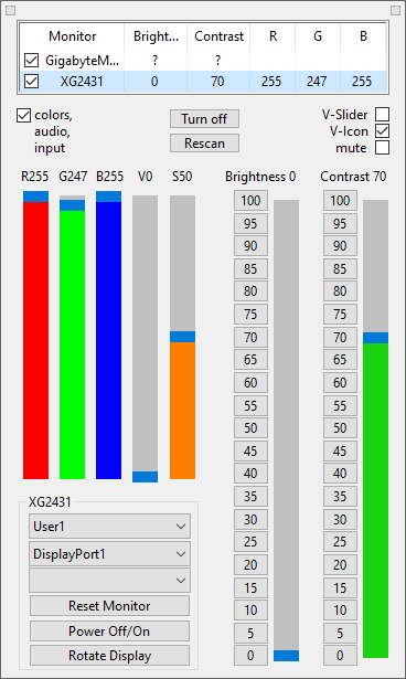

I found a tool that allows me to change the rest of the standard parameter while still in the Service Menu, called ClickMonitorDDC.
Very convenient if I want to play with ISET and adjust RGB values, Contrast, Color Profile, Source Input, etc.
Still, I wish I didn't have to use workarounds and break warranty to turn brightness lower than 85 nit.
ClickMonitorDDC
ClickMonitorDDC
