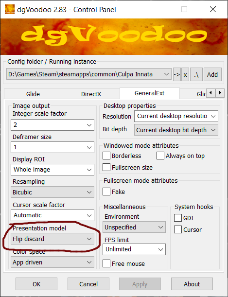

I forgot to mention a third option that works for old games that use DirectX 7, 8 or 9, or the very old 3dfx Glide API: DgVoodoo2. It converts these old APIs to DX11 and provides an option to use discard flip presentation model:Windmill1055 wrote: ↑04 Dec 2024, 08:35I haved searched the DXVK config with "flip" keyword but found no match. I do not know is their anything like the directx's flip mode in the vulkan api and what exactly did SK do to solve this problem. But anyway, thanks you and the guys developing SK, it really help me a lot!
To see this option, you need to right-click first inside the window first and enable the option that shows all settings. dgVoodoo is generally the best option for very old games that have issues on modern systems.
