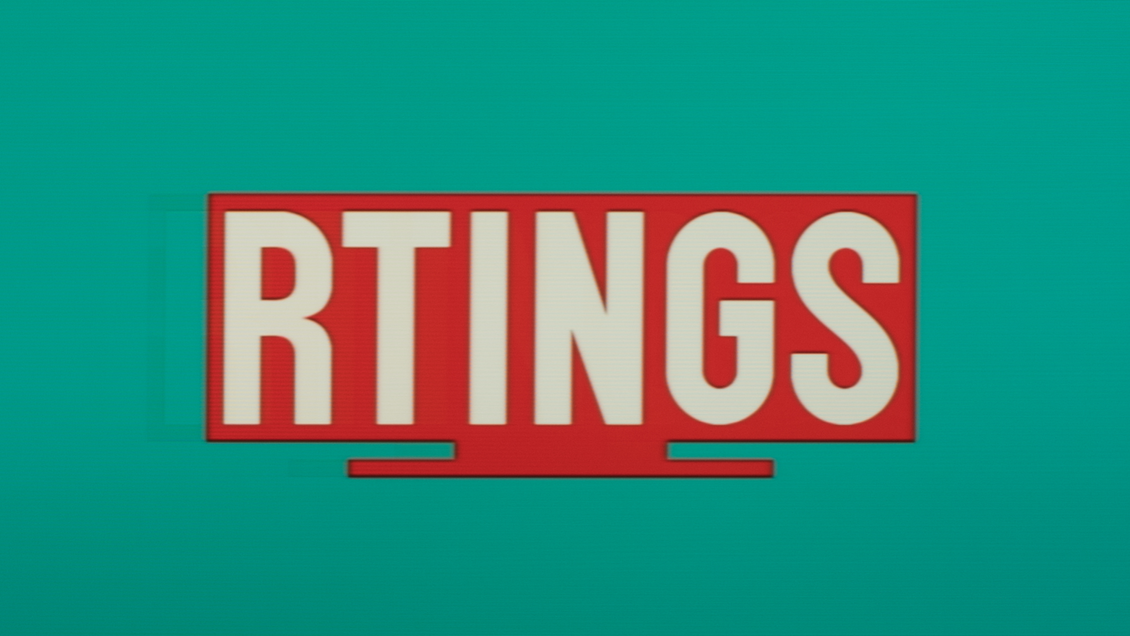

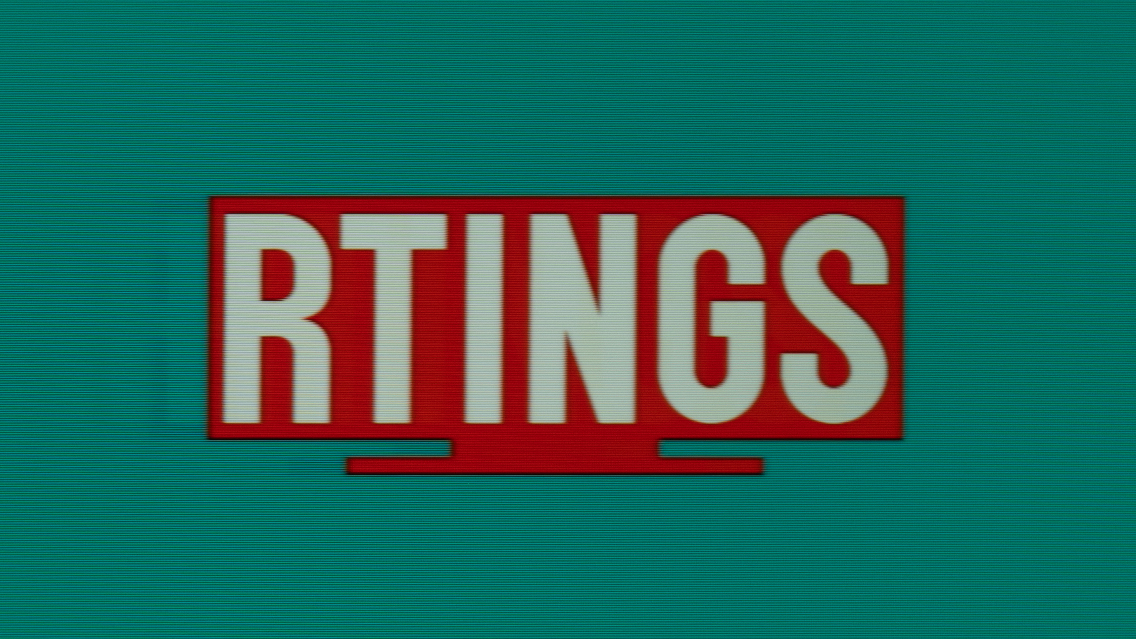

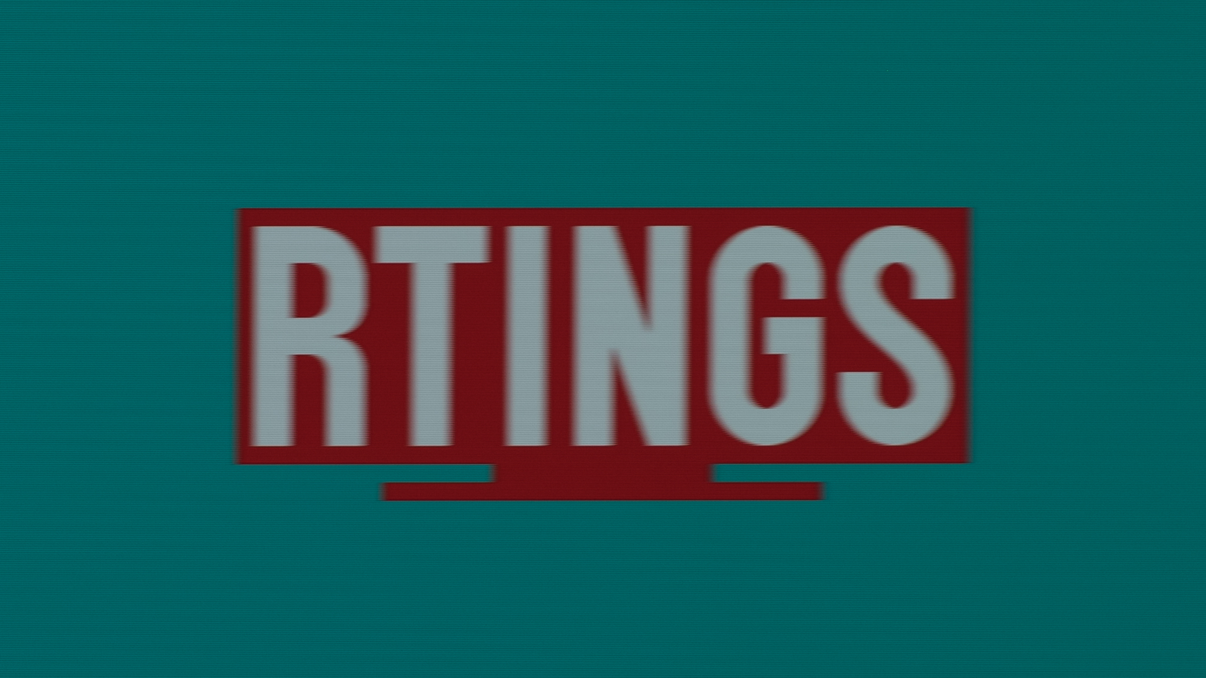

For reference, I'm adding the picture for the 2024 models QN90D, QN95D, and the 2020 LG GX, the latter being the lowest MPRT 4K OLED at 60hz and 120hz w/ BFI set to high (x4 motion clarity multiplier).
I'm not sure if the GX and QN90D results are captured at 60hz or 120hz. QN95 appears the clearest, but is a bit dim and BFI is limited to 60hz, so I'm leaning towards the QN90 and hoping the test result is representative of 60hz BFI...
I'm comforted in the idea that those are worth investigating in the here and now. I don't know when OLEDs will come with native 1000+hz panels (and again, I assume the input signal will be lower for a good long while, especially at higher res), but obviously, as long as frame-gen keeps improving, it is the absolute way to go in order to preserve HDR peak brightness.
So, I tried your strobe crosstalk test on my PG27VQ, I do get some artifacts in the lower part of the screen, but it's a small price to pay for the CRT-level clarity afforded to me by ULMB.
So if I understand correctly, as long as the crosstalk artifacting on top and bottom does not completely ruin the motion, I would be correct in my belief that those 2024 Samsung TVs are the lowest MPRT HDTVs on the market in the here and now, based on their BFI Image test results for RTINGS then? The closest thing to a giant 4K CRT we can actually buy today?

Yeah, I really combed through all the BFI picture tests in the table tool. Not only are those two the best results for TVs currently on the market, but also of all the past TVs with older test protocols. I simply could not find one that beats those.
I mostly concentrated my analysis on the thickness of the fringe of blur on the sides of the letters. And on LCD models, I paid attention that the ghosting and double-image artifacts were tolerable.
In which case the 60hz-only QN95D is the best, but I wonder why it shows such a dark outline all around the logo elements, that also appeared on the last-gen QN95C's BFI test, which leads me to believe it is an artifact of those TVs motion processing.
I'm still leaning towards the QN90D, hoping that the test image was done at 60hz and that the 120hz mode closes the gap with the QN95D while maintaining a higher brightness. I can definitely wait to see the results on next year's models of course.

After looking at the BFI graph, I believe with some certainty that the GX and QN90D BFI picture test were conducted at 60hz and should therefore both be clearer at 120hz.
Also, I had dismissed the 8K models from my analysis, but the QN900A/B/C/D all display exemplary BFI test results.
Only the QN900A and QN900B strobe at 120hz though.
The former retains a lot more brightness, the latter has far superior contrast.
It's really hard to decide and a bit infuriating that newer high-end models have very dim 60hz-only strobing.
I'm again in that GX/G1 situation where a crucial features seems to go the way of the dodo and I resort to buying discontinued models instead...
While I don't care for native 8K in the absence of content, it is relevant to retro gamers, as it is the first resolution to be an integer of ALL major standards: 240p, 480p, 720p, 1080p, 1440p and 2160p...
One could imagine using a scaler to bring a 480i/p signal to 1440p and let the TV bring that to 8K...With low-MPRT and CRT mask filters, when I bring up the giant CRT emulator, now we're really talking....
Edit: Pictures for reference (assumed to be at 60hz)
Edit 2: From what I understand, the QN900B has more settings for local dimming, and it's fairly safe to assume that the BFI test was conducted with it set to Local Dimming High, perhaps that is why the BFI graphs are affected on some models (tiny hills instead of sharp peaks). I emit the assumption (because assuming is the best I can do at the moment) that, with a more modest local dimming setting, we could have more brightness when strobing is on, perhaps matching or beating that Q9N00A which, with its sole local dimming setting set to On, still has much lower contrast in comparison to the QN900B with Local Dimming on High... What a rabbit hole...
