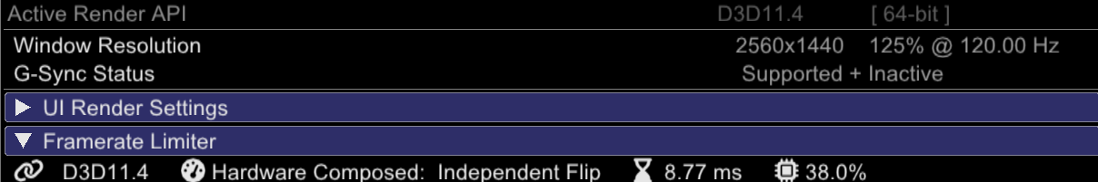

Try installing SpecialK and launch a game in it (make sure it's not an online game as those have anti-cheat systems that can get you banned if you use injectors like SpecialK.)
In SKIF, in the settings tab, enable performance logging for your Windows user account and reboot. Then launch a DX11 game and configure it to use borderless windowed mode instead of exclusive fullscreen and exit. Then launch the game through SKIF and in-game press ctrl+shift+backspace to bring up SK's control panel and check the g-sync status as well as the current presentation model (the field where in this screenshot it says "hardware composed independent flip"):
Also check if this makes g-sync work correctly.
