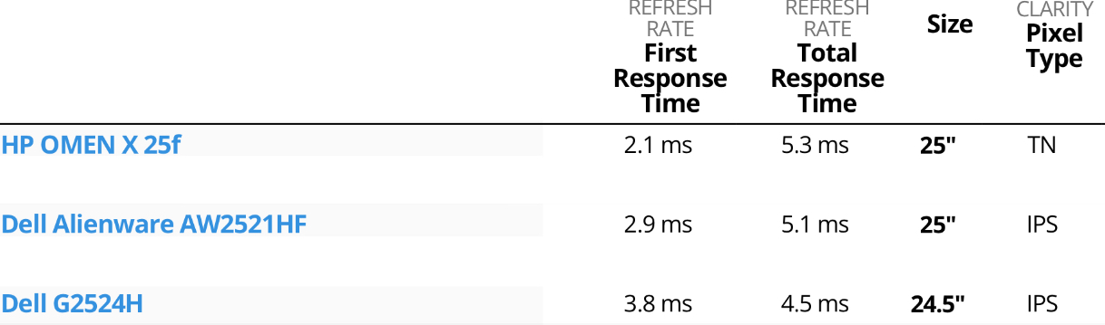

Hello everyone, I have been doing some research and I chose three monitors. Help me decide which one will be the best.
1. OMEN X 25f with a total response of 189hz and first response of 2.1ms
2. Dell G2524H with a total response of 222hz and first response of 3.8ms
3. Dell AW2521HF with a total response of 196hz and first response of 2.9ms
I cant fully understand what exactly “first” and “total” responses do. If someone explained in a way that cs player would understand, would be really cool. I am curious about motion clarity, ghosting, smearing, screen tearing, input lag, responsiveness. Excuse me if I wrote absolute nonsense.

Skip all 3. Why? They have subpar G2G response times compared to the offers below.
Go for one of these:
XL2546X+, XL2566X+, AW2523HF, XG259CMS, XG259QNS or 24G2ZU/XG2431/VG249QM1A/XG249CM (they all house the same panel)
Odyssey G4 or 25G3ZM are ok but it's better to go for panels above.

XG259CMS uses a 310Hz (OC'd) panel, exact model is: AUO M250HAN03.5, which is a native 300hz panel.
XG259QNS uses a 380Hz (OC'd) panel, likely using the same old 360Hz AUO IPS panel as older 360Hz IPS displays.
The Q25G4S (panel: HKC SN245ES01-1) is a personal favorite of mine due to the the higher density, smaller screen size and relatively excellent refresh rate target at a great price point.
I assume you can also skip the DSC sheningans by using the HDMI2.1 port on it
Here are a few reviews I was able to find:
https://www.bilibili.com/video/BV1MqQhY6EDj/
https://www.bilibili.com/video/BV1NqXHYkEeJ/ (has ufo)
https://www.bilibili.com/video/BV16cQoYcEK6/
I believe the latest rumor was that it's coming in June/July 2025, at a £239 price point.
If you can drive the frame rate at 1440p, I would whole-heartedly recommend the Q25G4S. The pixel density difference from 24" 1080 to 24" 1440p is amazing.
Otherwise, It might be better to opt for refresh rates which are divisible by 24, 30, 60 to have syncing in video content. Example of such refresh rates are 240hz and 360hz (which is my only gripe with the Q25G4S...)
Q25G4S > XG259QNS > XG259CMS in terms of desirability imo, but your use-case might differ from mine.
Hope this helps.
