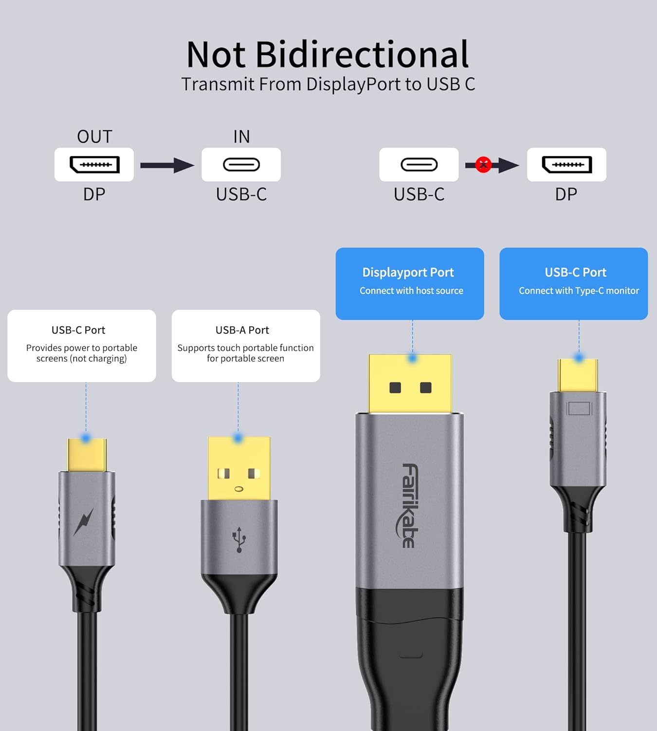

I have also tried a bidirectional cable (Club 3D CAC-1557) with no results using my RTX 3080 or RX 6800. I know the cable works as I have used it on other portable monitors with success. It seems that the firmware on this Asus MB16AHG portable monitor is a bit more restrictive. A purpose built cable might be needed to get it to work. I know that bidirectional cables only send a display port signal and no power or USB data lines. Maybe the firmware of the monitor is expecting power and USB data as that is what DP alt mode also provides. Maybe something like this might work (you can find these cables on Amazon):
I have bought one of these and are going to try it in a week or two to see if it works.

After it took a while for the cable to get delivered, I can confirm it works. You need to connect the displayport and power first before connecting the type c to the monitor. USB data connection is not required (if you plug data in, a "Generic USB Hub" will appear in device manager, it might be used for Asus DisplayWidget Center, I am not sure). The cable I bought was this one: https://www.amazon.com/dp/B0BW8QKFHK
I can also confirm the Freesync is working over displayport, range 60 Hz to 144 hz. This confirms my theory that the monitor is expecting displayport with power to even attempt connection with the host. This should not be designed like this, but I am pretty sure the firmware of the monitor can not be updated or changed to fix this.
