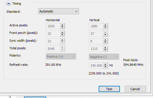

-Take a screenshot of your current resolution timings in the NVIDIA Control Panel. (pic1)
- Go to your monitor manufacturer’s website and download the official driver. In Device Manager, your monitor should show its full model name. (pic2)
- Connect your monitor to the motherboard (make sure iGPU is enabled in BIOS). Open CRU (Custom Resolution Utility), go to the Extension Blocks section, and select Detailed Resolution. This might be under the “CTA-861” block or “DisplayID 1.3” block.
- Find the resolution with the highest refresh rate and compare its timings with what’s shown in the NVIDIA Control Panel. If they don’t match, the NVIDIA driver applied incorrect EDID data.

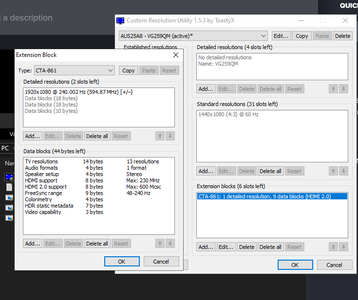

- Take a screenshot of the detailed timings from when the monitor was connected via iGPU. Then reboot and reconnect the monitor back to your GPU.
- Open CRU again, go to Detailed Resolutions, and manually set the timings to match what you saw with the iGPU. (You need to delete all existing Extension Block entries and recreate them using the iGPU timings.) (pic3)
-Restart the GPU using CRU’s restart tool. Then go back into the NVIDIA Control Panel and confirm the timings now match what you saw when using iGPU.

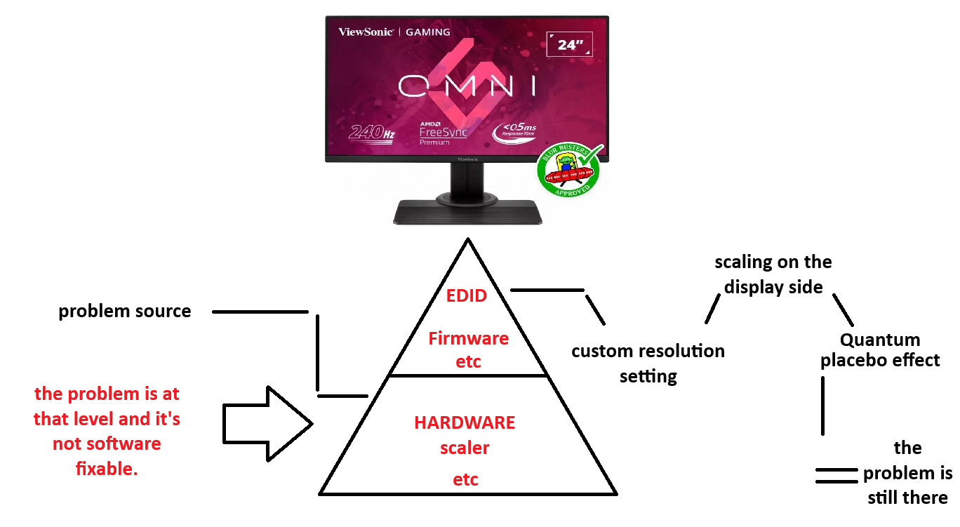

good information only for experimentation but not for solving the problem since the problem is in the hardware sector itself
after each tweak you are in a quantum state and it is not clear if the problem is solved until you collapse this state to faceit/valorant ranked

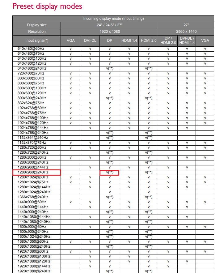

For example I have a monitor that is faulty from the factory and the scaling happens on the monitor side even at native resolution and I get a bad experience playing at native resolution.... I'm in the shackles of a bad monitor.benq zowie xl2546 For example, on xl2546 monitor when using 1280x960 @240hz resolution, the scaling should not be performed on the monitor side or on the GPU side because this resolution is native to the monitor!

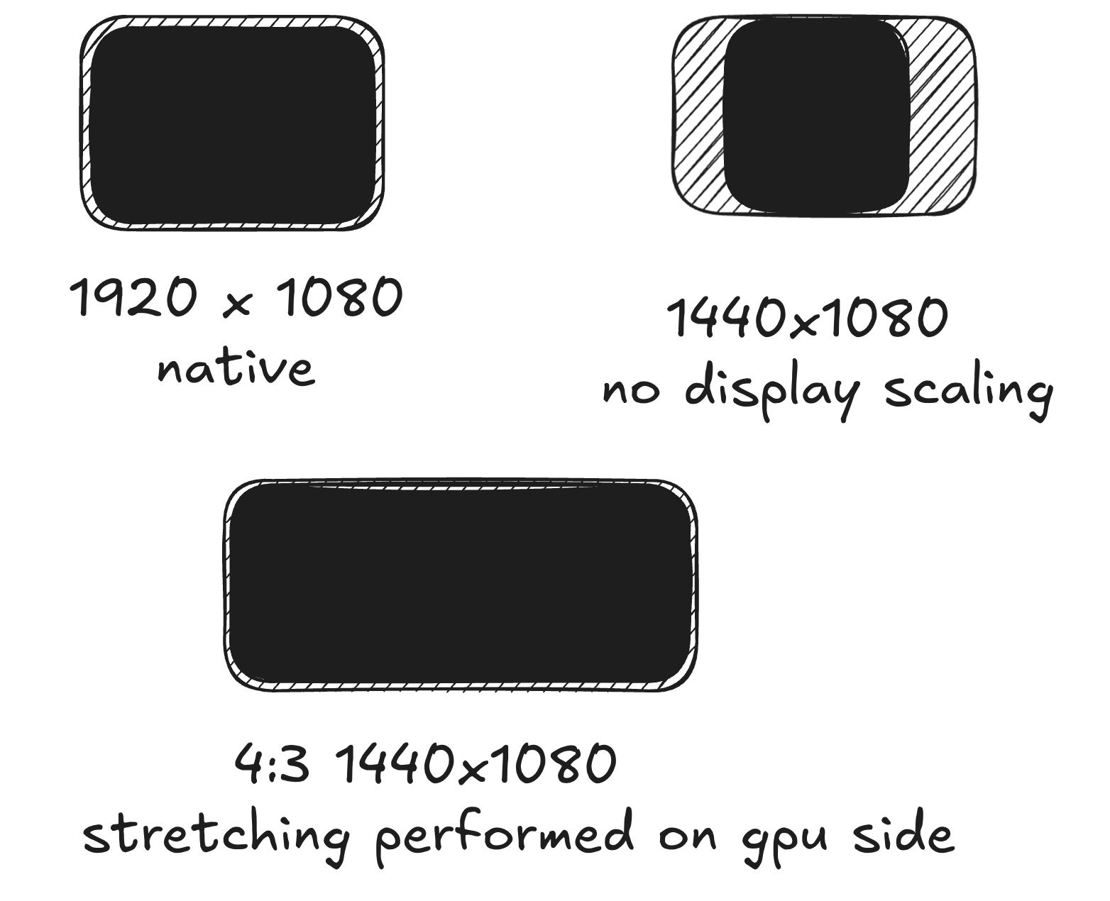

I read your post, it looks like your monitor scaling is not working as it should, in my case the native monitor resolution was parsed incorrectly and all resolutions that inherited it were blurry
I have a very basic understanding of how monitor scaling works at a low level. let's take my gaming resolution 1440x1080. 1080 pixels is the native number of pixels in height. 1440 wide, if i select “no scaling” i get a picture with black bars around the edges, then i select gpu scaling to fit width, gpu only stretchen to the edges of the screen.
*1080 pixels height is native
in my case the problem was EDID, the monitor does not engage any scaling.

"Take a screenshot of your current resolution timings in the NVIDIA Control Panel"
I dont think nvidia showing your current resolution timings
Probably they are just what auto will assign when you create your custom res.
