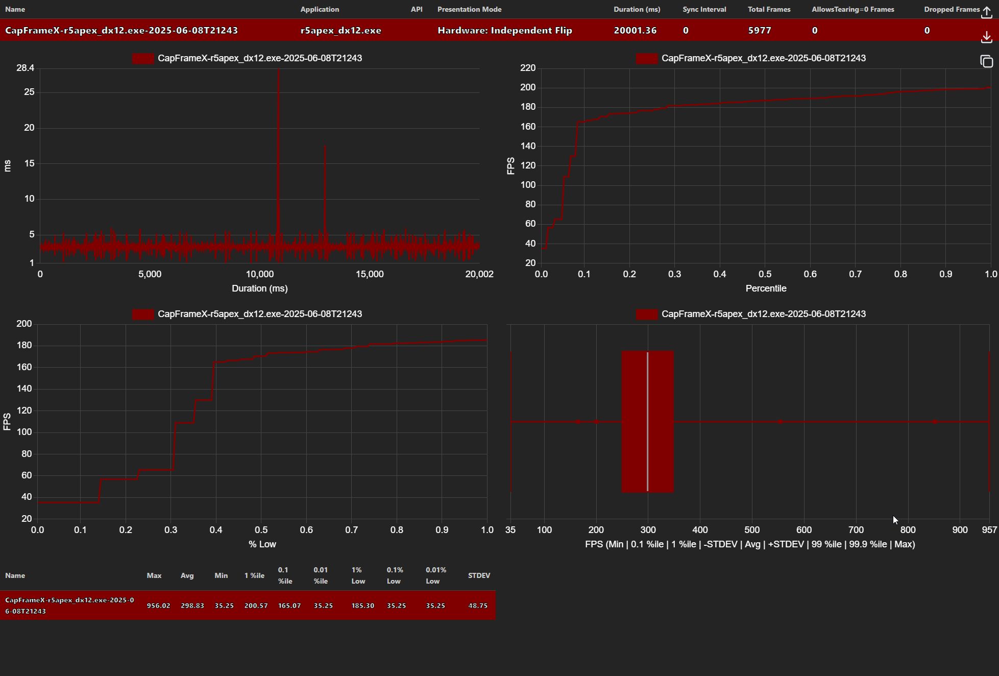

I tried playing Apex yesterday and got 0 "visible" stutters, my game felt pretty good but when i tried CapFrameX my frametimes looked pretty weird.kyube wrote: ↑08 Jun 2025, 17:07Did you happen to experience these stutters in a title such as Apex, Dota or Deadlock, which are also a Source-based game?uwaaa wrote: ↑06 Jun 2025, 20:42Hi! I've been getting random stutters in CS that I can’t seem to fix. Not tied to fps drops, just little hitches that happen every now and then. Happens in both CS2 and CS:GO.
Specs:
9800X3D | RTX 5070 | G.Skill 2x24GB 6400 CL32 | X670E Tomahawk | 990 Pro | RM1000x
Tried so far:
Completely stock BIOS | JEDEC, EXPO, and manual primary timings | Stock clocks, PBO off
Different NVIDIA + NVMe drivers | Reflex on/off | RTSS on/off
Instabilities may be more apparent in one engine (Source) far more than they do in other engines, due to the specific instructions executed during play.
Thank you for including a ZenTimings screenshot.uwaaa wrote: ↑06 Jun 2025, 20:42Temps are all solid imo, CPU tops out at 50°C, RAM at the very max 40°C, GPU around 45°C. Nothing running in the background, even steamwebhelper is disabled.
I'm currently running 5.1GHz at 1.175vcore, SMT off. RAM timings below (only tweaked tRCD, tRP, tRAS), with 1.4V VDD, 1.37V VDDQ, and 1.2V VSOC — rest on auto. These tweaks helped reduce stutter a bit, but the core issue is still there.
Also noticed something odd: if I clear the shader cache, the first launch of the game runs buttery smooth. But every launch after that, the stutters come back, this happened 5 times now.
Other games like Overwatch 2 run perfectly. I can cap FPS at 600 and play for hours without a single stutter or frametime spike. So it feels like a Source/CS-specific issue, but I can’t rule out some system-level quirk either.
Anyone else running into this on similar hardware or have any leads?
The biggest issue, which I see, is you owning a 5070 (RTX 50 series) GPU... as obscure as this sounds.
The past few drivers of Nvidia have been very subpar and I don't have any other recommendation other than trying a different GPU and troubleshooting afterwards...
it could be some X3D + 50 series combination issue, which only manifests in rare cases.
There's a lot of potential mismatch happening...
- brave_mKy1mqxKhe.png (164.66 KiB) Viewed 7608 times
