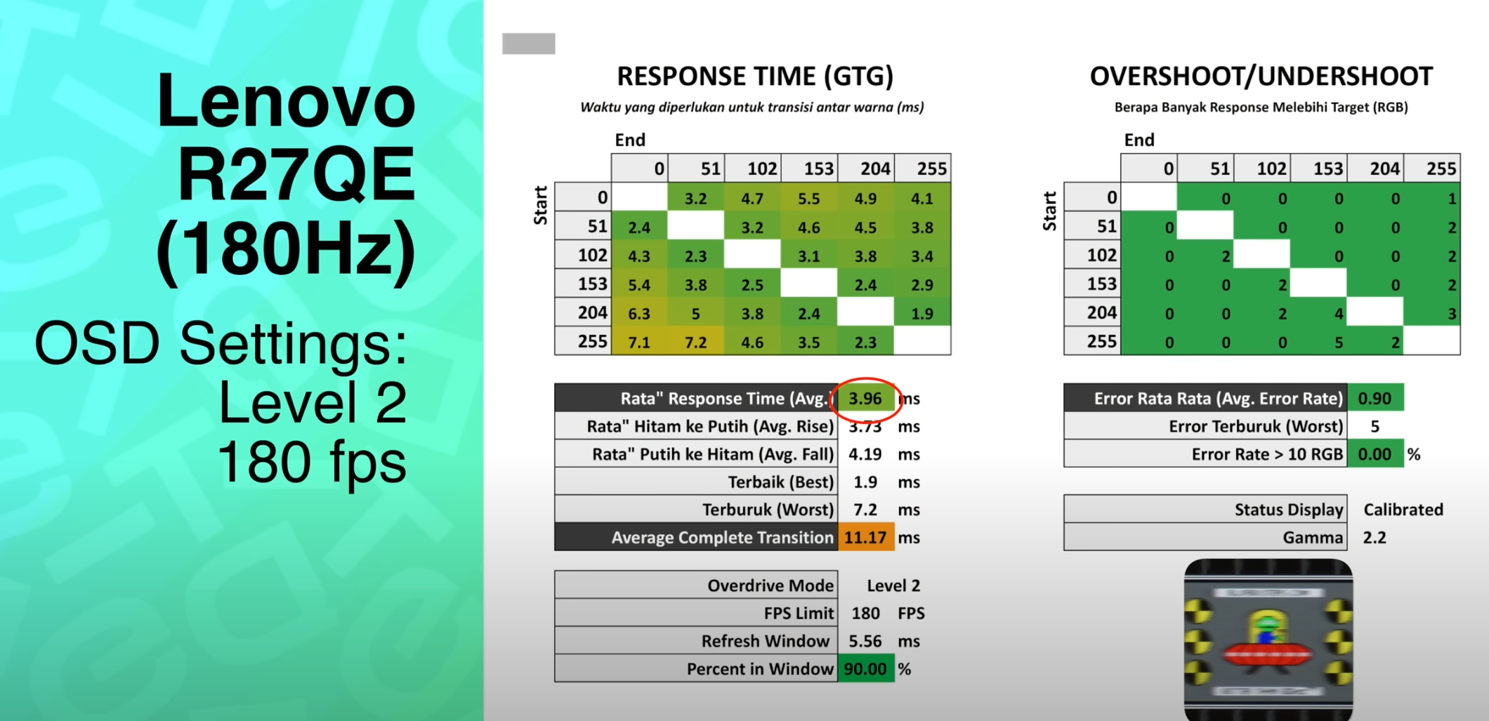

also the response times he was refering to were
i was told these response times are important, they decide when a pixel changes its color

I think you've misinterpreted how G2G RT's work.
What those heatmaps represent are gray-to-gray response time transitions.
For example: RGB(255,255,255) - RGB(0,0,0) is 1 such transition (pure white to pure black)
The general goal of G2G RT's is to be below the refresh rate (might be easier to think of Hz as ms)
This means that, a theoritcal LCD whose G2G RT values are below the refresh rate should look almost identical to OLED (""GtG=0"") in terms of eye-tracked motion performance (e.g.: moving object, you track it with target)
This means: if you have a 240hz display, you want all possible combinations to be <4,17ms (1000 / 240 = 4,17ms)
Now, in practice, most desktop IPS LCD's perform almost identical (5-10% difference in heatmaps) in terms of G2G RT's.
This means, to get (eye-tracked & fixed-gaze) motion clarity benefits, you want the highest refresh rate possible within your budget and your choice of pixel density (resolution)
This also means that a desktop 180Hz LCD IPS panel cannot be sharper in eye-tracked motion (let alone fixed-gaze) clarity than a desktop 240Hz LCD IPS panel.
The 2 images in my previous post above show how motion clarity increases depending on refresh rate increases (the images above assume you do FPS>=Hz)
I believe Chief's post + mine are enough for you to form your purchasing decision :D

i understand it, however as far as im aware it doesnt take into account that response times being longer than the refresh window creates worse motion handling in ghosting and smearing
