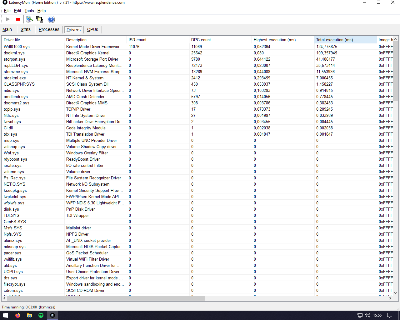

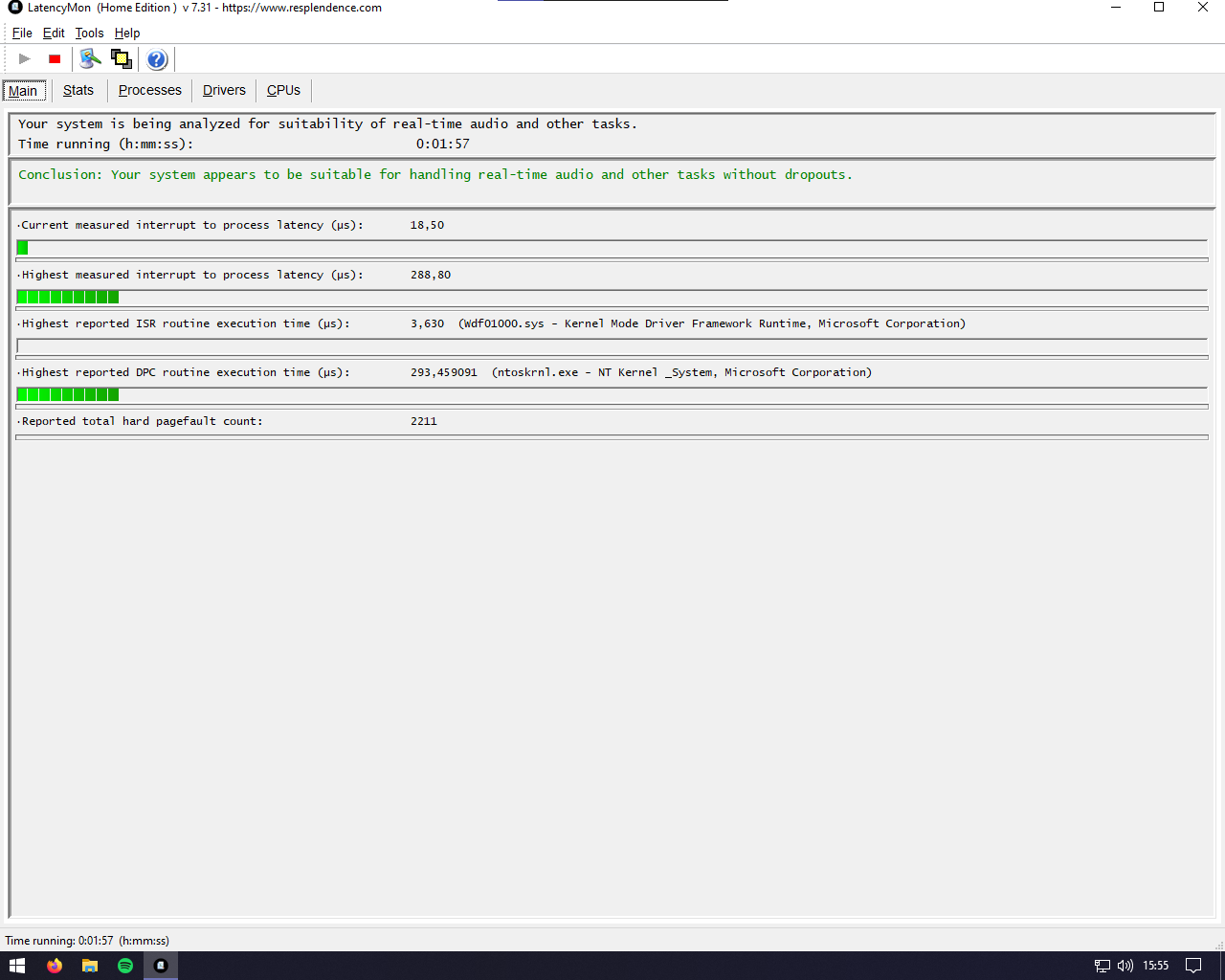

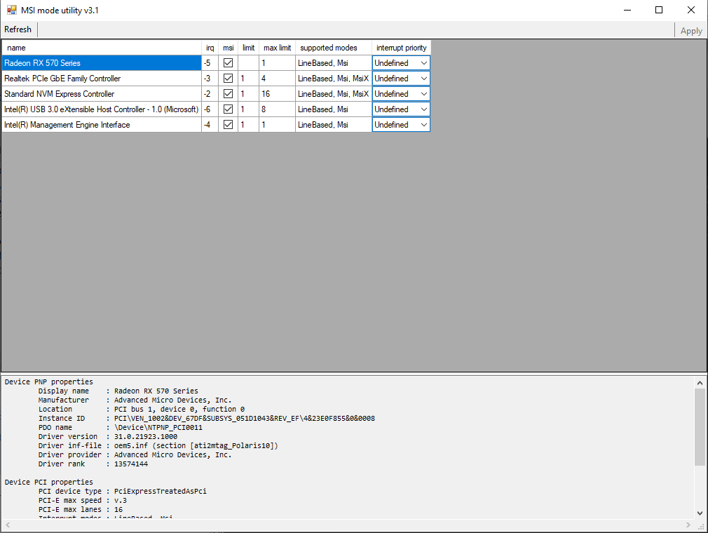

Greetings!
So, long story short I've been having issue where I can't really figure out why is ntoskrnl.exe slowing down my system. Since I've done a lot of testing, I will try to debrief everything I've tried/done:
- Clean Windows 10 (Atlas 22H2)
- Minimal drivers meaning I've installed only chipset driver with necessary drivers for GPU (RX 570) and external audio card (Focusrite 2i4)
- I've disabled SATA controller in bios and audio controller aswell
- I've configured MSIUtilV3 which I will post a picture of
- Disabled ULPS
- I've tried all of the USB port combinations, just to test it out
- Processor Idle demote and promote are set to 100% in power plan
- Tried older ethernet driver (RTL8111G) but it performs pretty much the same even with the newer driver
The latencymon pictures are captured on a clean reboot, with keyboard and mouse connected only with nothing running in the background. Any help would be highly appreciatable, cause I'm not sure what more can I try. Thanks
- Disabled ULPS
- 3.png (29.55 KiB) Viewed 14840 times
- 2.png (110.26 KiB) Viewed 14840 times
- 1.png (59.62 KiB) Viewed 14840 times

- LatencyMon is a useless test to evaluate DPC/ISR performance. Refer to the thread in my signature for more information.dsavovic25 wrote: ↑27 Jun 2025, 07:03Greetings!
- Disabled ULPS
Instead, use ETW-based scripts, such as xtw or xperf (the former is preferable)
https://github.com/valleyofdoom/xtw
https://github.com/valleyofdoom/PC-Tuni ... dpcisr.bat
- External audio cards cause severe audio latency & USB driver overhead, avoid using those and opt for onboard controller (ideally ALC1220 or lower, optical out)
- Custom pre-built ISO's are usually detrimental to performance, follow https://github.com/valleyofdoom/PC-Tuning instead.
- Could you tell us the full list of your HW components? I assume you're trying to find a culprit for your low FPS.
No amount of DPC/ISR optimizations can circumvent the severe GPU bottleneck you'd have in competitive games.
