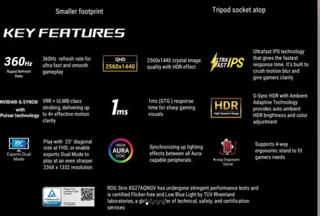

Article makes a mistake anr says 1000hz clarity but the marketing says 4x. So rounded up 1500hz.
I wonder if that means 120hz strobed gets limited to 4x too or... Guess we will know in 2 months
Posted: 14 Dec 2025, 19:40
by radeko
4x Motion clarity. It could be rolling BFI.
Only 400nits of Brightness . It not sounds good for full frame BFI. But rolling BFI done in one frame could give more light
Zrzut ekranu 2025-12-15 013759.png (177.09 KiB) Viewed 31914 times
