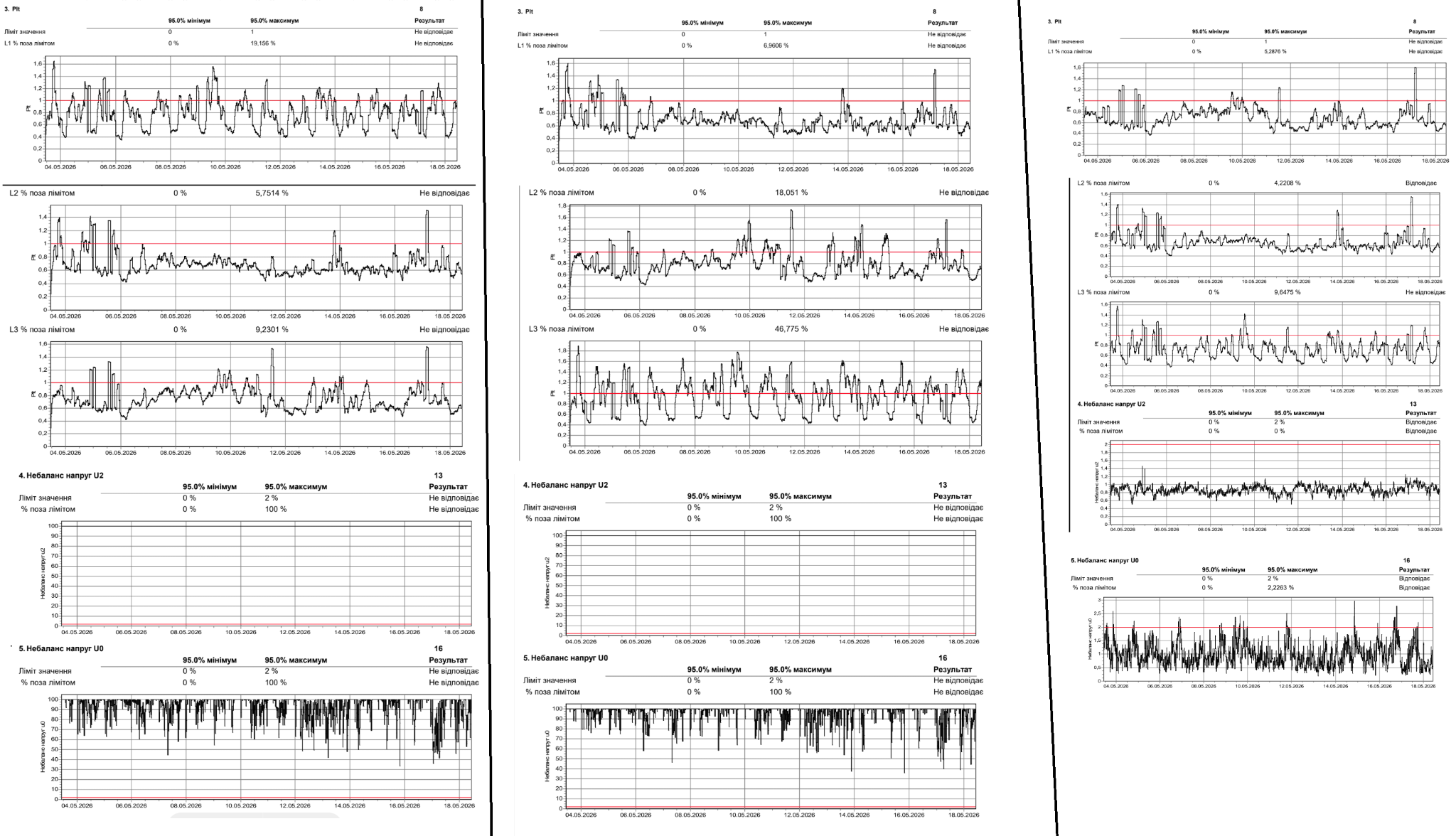

Electrical findings: official measurements by DTEK showed excessive flicker, severe voltage unbalance, U0 outside limits, U2 outside limits, multiple voltage sags, full interruptions. Transformer-side measurements were significantly better than measurements closer to my house. I can attach documents from all three phases over multiple seasons (spring 2025 to spring 2026, yes, entire year). But they are in Ukralnlan.
The utility is currently monitoring the line 24/7 and plans to transfer ownership of the line and rebuild it, since parts are not officially owned. This process may fix it, but it is not guaranteed.

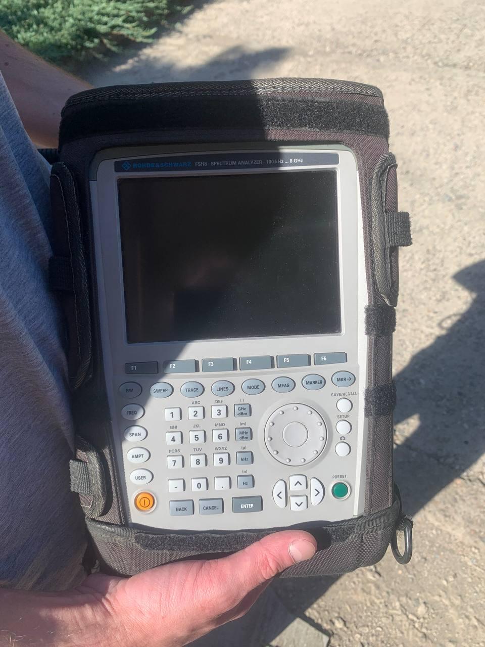

And I had an radio-monitoring inspection at my place. And that's the response they sent me: "Based on the results of the measures carried out by employees of the Central Branch of the UCRF in your presence on the premises and in the rooms of the building, in the public radio frequency bands, including the frequency bands for cellular radio communications, terrestrial television broadcasting, terrestrial analog audio broadcasting, and broadband wireless radio access, there were no violations of the radio emission parameters of the specified radio technologies and unacceptable radio interference in the public radio frequency bands.
It was recorded that the PC system unit itself emits broadband radiation in the approximate range of 308-730 MHz with levels up to ~60 dBm.
In addition, we would like to inform you that the Central Branch of the Ukralnlan State Centre for Radio Frequencies has not received any requests from operators providing telecommunications services in the village of Yours or from other residents of the specified area to identify and eliminate sources of radio interference that may cause reception problems in public radio frequency bands."
I am attaching a file of the device used to take measurements at my place via the Central Branch of the UCRF.
I also invited a metrologist who brought a C1-67 universal oscilloscope, and we checked the sinusoid, and everything was fine with it.

Here I attached
Spectrum analyzer that Used by UCRF inspection;
Power quality measurements from DTEK (flicker, voltage unbalance, U0/U2 deviations) Phase imbalance and flicker graphs collected during monitoring period.These are included for reference, not as conclusions.

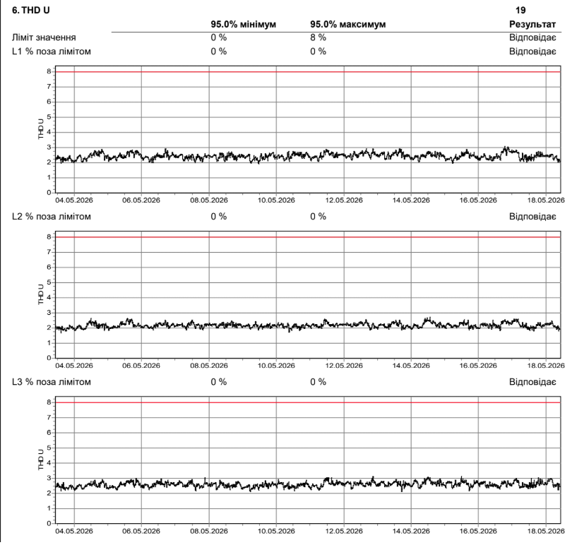

The PC itself has no issues, since the PC, including the monitor, is working fine in different places. Unfortunately, I don't have an option to move any more. So I'm stuck in my place for some time.
I even had a chance to be powered from another source rather than my Thermal power station, and the difference was there, but not that big of a deal.
One interesting observation came from testing the same PC while being supplied through three different 10 kV -0.4 kV distribution transformers.
The gameplay characteristics were not identical between them. However, the differences appeared to correlate much more with the instantaneous load on the feeder than with the transformer itself.
In other words, changing the transformer changed the behavior somewhat, but it did not eliminate the issue. This suggests that the transformer may not be the root cause.
Here I attached Transformer (THD)
- thd.png (112.13 KiB) Viewed 4448 times
