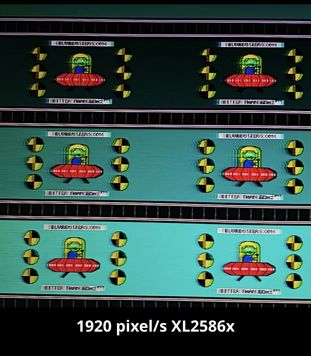

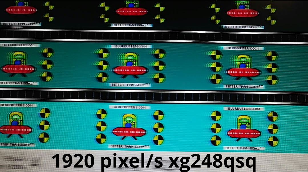

all at 500hz, not much if any difference when 540hz or 610hz
asus newer model has worse strobing than its predecessor, on on its highest level 5 clarity, is dimmer than zowie xl2586x, and worse
after looking back, not the clearest image, but in person, the asus looks a bit clearer than the zowie, but the double imaging is worse
