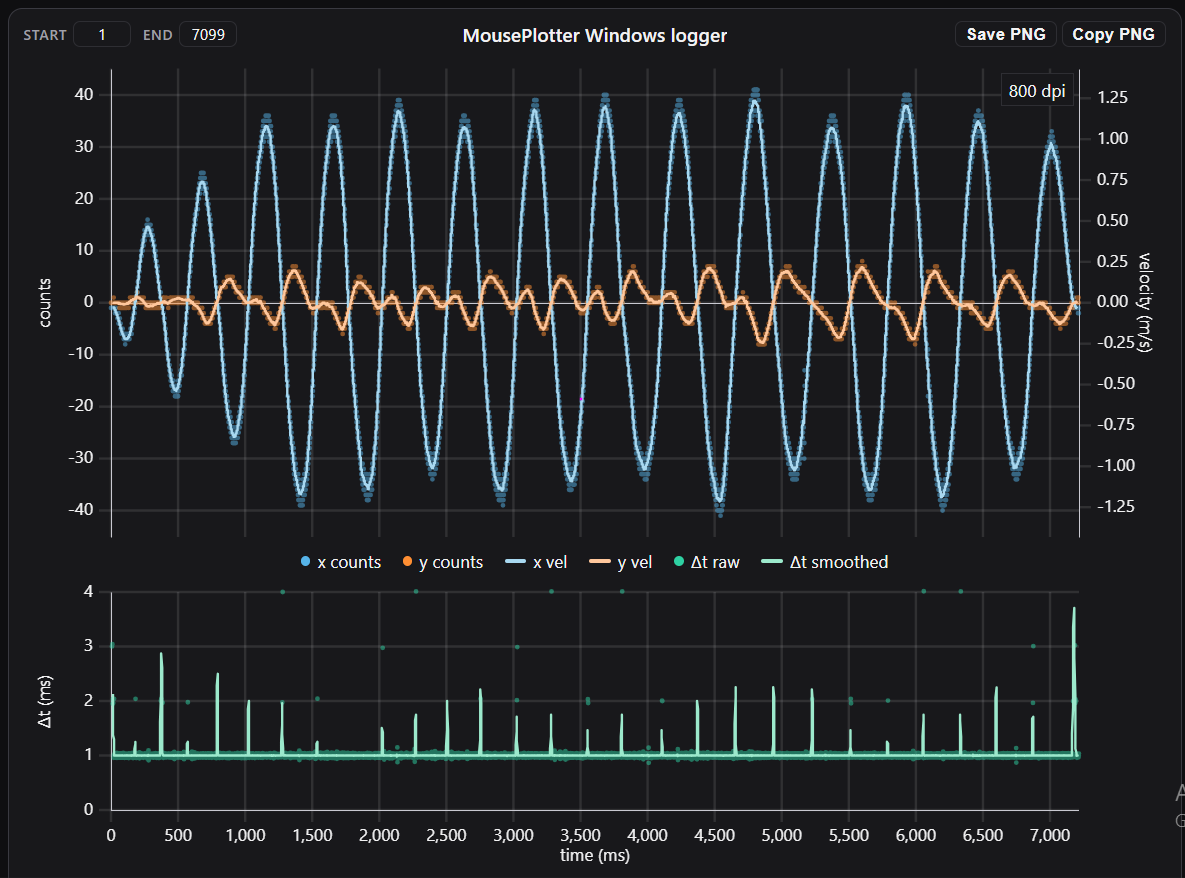

Found this new mouse plotter tool. I like it a lot better than the old mouse plotter tool that everyone uses.
It's better to use the standalone exe. Gives you cleaner results as the browser can interfere with the readings.
These are my readings for my G Pro 2 wireless mouse @ 2000hz.

It needs to display 99.9 percentile deviation like how MouseTester does. The graph looks nice, but it's faster to look at the actual values.
I tested with a Logitech MX518 Legendary 1000Hz.
XBAB-Tech MousePlotter is giving me about +-0.05ms to +-0.10ms worst case. MouseTester is +-0.10ms. Occasionally I get a slight spike, about 0.2ms in both. The spike in the beginning is from me bumping the mouse.

Clearly 1 person here already was able to get quantitative info from the tool to show that he has frametime issues.
There are some apps/services that I run where it will show up in the mouse plotter test as instability. When I close/disable them, the readings become more stable. Whether or not it's sophisticated enough for your liking, it's still a good enough tool for everyone else to surface any issues they may be having.
edit: in my original test, i didn't close the usual apps i close when i play a game. here's a test where i did do that, and the readings are a lot more stable and less noisy.
These are my readings with it wired @ 1000hz, it's capped at 1000hz wired for some reason. My previous tests were using the wireless receiver @ 2000hz. I'm curious to see other peoples wireless receivers performance with the test.
edit 2: I decided to go over my bios settings. Then I noticed some settings were set to AUTO. So I set all the AUTO settings to something definitive. And it cleaned up my mouse reports and made them more stable. The test below is wireless @ 2000hz. These were the settings I changed.
PCIE_E1 to gen 4
Chipset to gen 4
Global c-states to Enabled
Idle Current Power Supply to low idle
The x & y plot is a lot more stable and less erratic. And the ms plot has less deviations. Looking more like my wired test.

Oh my god bro, nvm. scratch all this. I just realized the reason im getting spikes and you guys arent is beacuse you guys are moving your mouse in a circular motion and i was moving my mouse horizontally, the spikes are just when i pause and go in the opposite direction.
