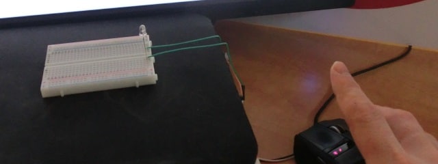

This article utilizes a creative invention (LED indicator attached to a mouse)

Essentially a modified computer mouse, that has a LED that is directly connected to the mouse button, and instantly illuminates upon button press (bypassing all computer latencies).
Then the LED is placed in front of the screen.

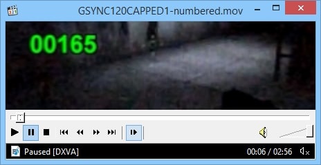

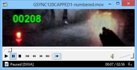

...A high speed camera (1000fps) is pointed at both the screen and LED simultaneously:
This is an example high speed video frame of a game scene.
The mouse LED turns on first, as the mouse button is pressed.
Finally, then the gun reacts several milliseconds later.
With 1000fps video, one frame is one millisecond. Conveniently, one can calculate the difference in frame numbers, between the LED illumination and the first gun reaction (whatever the first on-screen reaction is; such as a crosshairs animation, or gun moving upwards right before muzzle flash). This equals the whole-chain input lag in milliseconds, all the way from mouse button to pixels!
This makes it possible to measure GSYNC input lag, and compare it to other modes such as VSYNC OFF.
