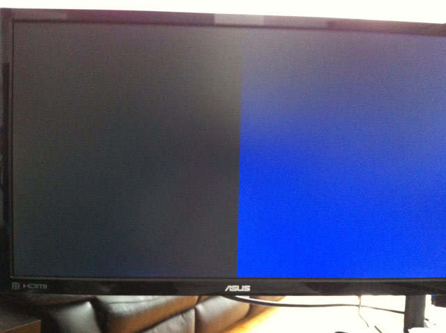

Anyways, I got everything put together and turned on the monitor and.. disaster!:
There was a blue tint to half of the screen!
It was still there while booting into windows, but it was semi-transparent. Many possibilities started rushing through my head - was it because I was running sli? No couldn't be - that would be every second scanline.. that tricky blue ribbon cable maybe..?
I took the monitor apart again (was a lot easier the second time!) and re-sat all of the harnesses, I tried it again and same thing.. the cursed blue tint!

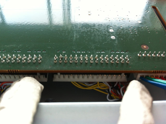

I opened everything up one last time, just to assure myself that there was nothing else that I could do. I started examing the board a little closer and lo and behold I found this!:
Can you see it?
A sloppy string of solder was making contact between two pins, I tested continuity and yep they were bridged!
I popped off the string with the included Nvidia pry-tool/ solder-remover and all was well!

Ptolmy wrote:A sloppy string of solder was making contact between two pins, I tested continuity and yep they were bridged!
Wow, glad you were able to figure this out -- this common "solder bridge" defect isn't something that most users would notice.
Thank you very much for making this post! This does a service to the community, knowing you fixed an issue with the DIY kit. Obviously, with the shipping monitors, this will be less of an issue as they get a chance to test the monitors completely assembled, while with the DIY kits, it's much harder to pre-test the boards before shipping them out.
