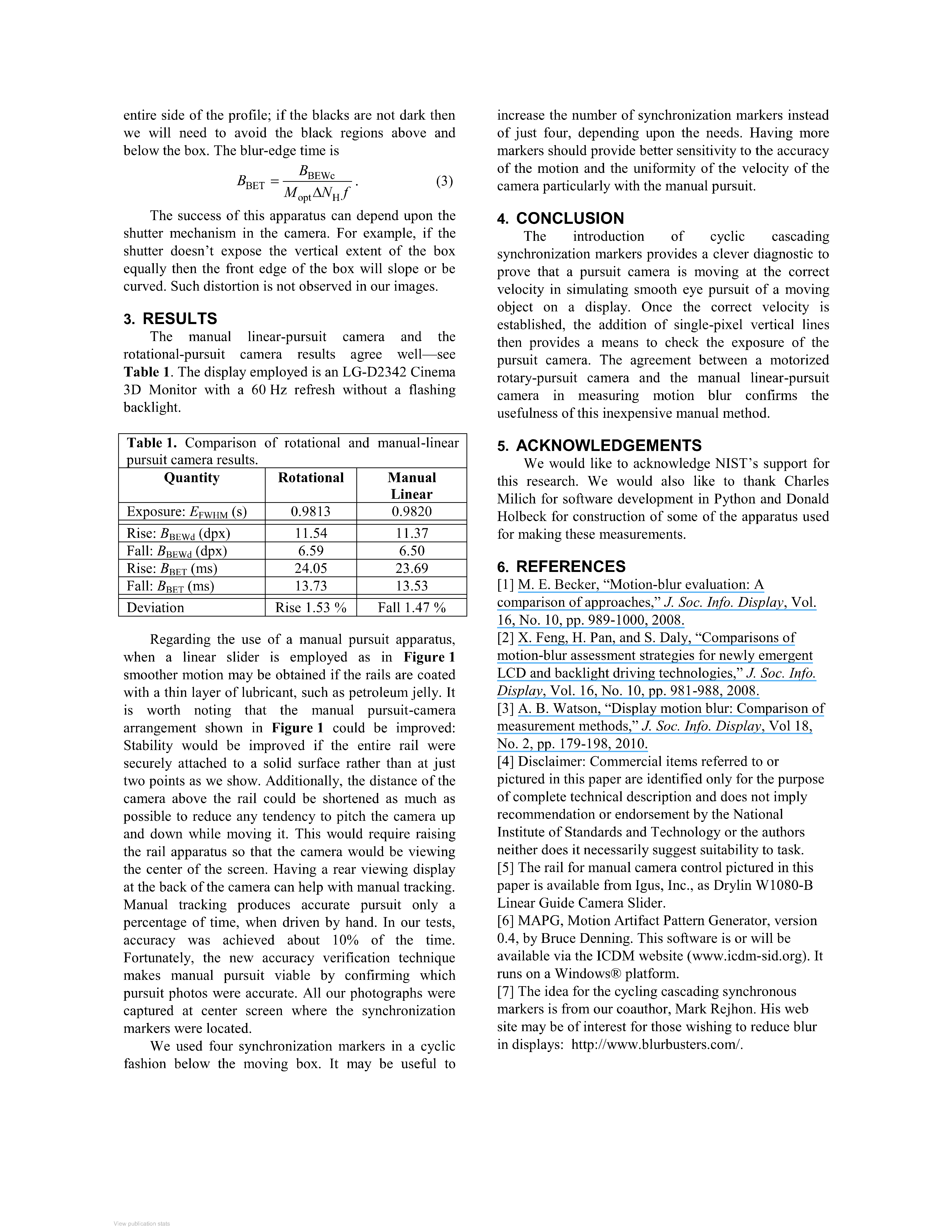

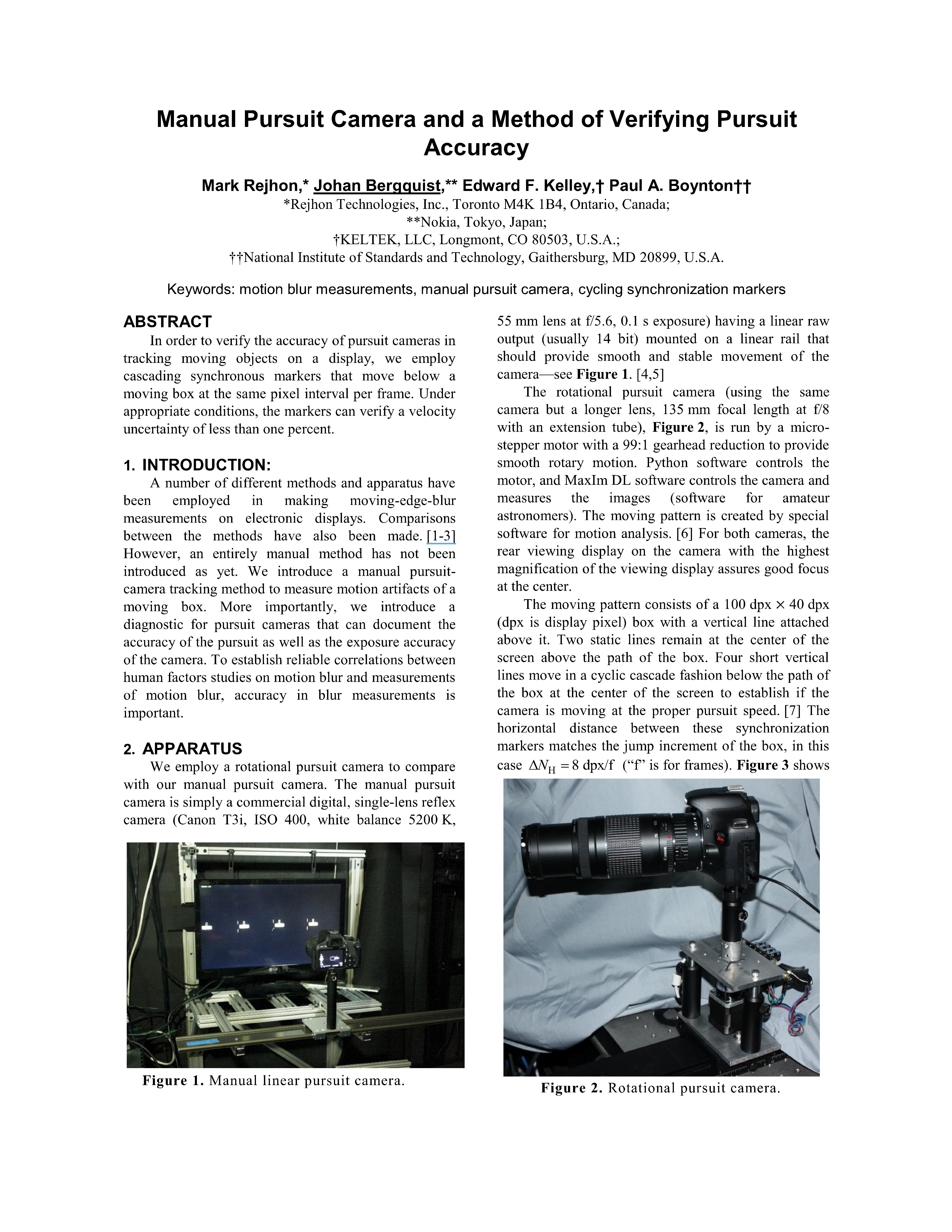

BEHIND THE SCENES: Wonder how we do photographs of motion blur, using a scientifically proven method? How we do manage very accurate WYSIWYG photos of motion blur, using such an inexpensive camera setup?
Here's new Blur Busters pages:
- Pursuit Camera Paper (peer reviewed)
- Display Testers/Reviewers using our pursuit camera technique
Co-authored with NOKIA, NIST.gov and KELTEK, and conference paper is on ResearchGate by yours truly Mark Rejhon (Chief Blur Buster).

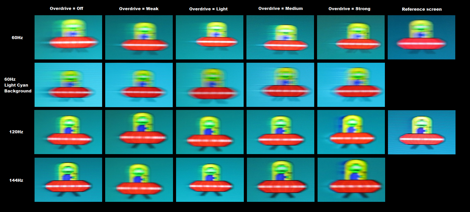

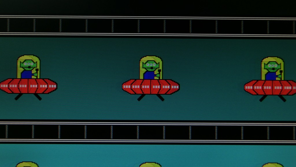

Reader Exercise....Try It yourself:
Want to experiment with pursuit camera images with just an iPhone/Android smartphone?
  1. Go to TestUFO Eye Tracking Test, subtest "Checkerboard": www.testufo.com/eyetracking#pattern=checkerboard.
    (Make browser window full screen.)
  2. Pan your phone camera sideways while trying to take a photo of the moving UFO.
  3. The live viewfinder preview becomes a checkerboard -- only whenever your phone is moving sideways!
  4. Take a picture by pressing shutter button while moving phone sideways. Best smartphone distance is approx 6" from screen
The more accurately you pan your phone sideways, the more accurate the checkerboard photo becomes. The only way to successfully photograph the checkerboard optical illusion, is to take a picture while your phone is moving sideways!
With absolutely no equipment (no tripods, no rails, etc), here's what I've been able to get with an iPhone hand-wave:
Phone cameras aren't always good pursuit cameras, but it helps anybody understand why we need to pursuit (chase the motion; aka the moving UFO) the camera in order to take accurate photographs of perceived display motion blur. Try it now!
