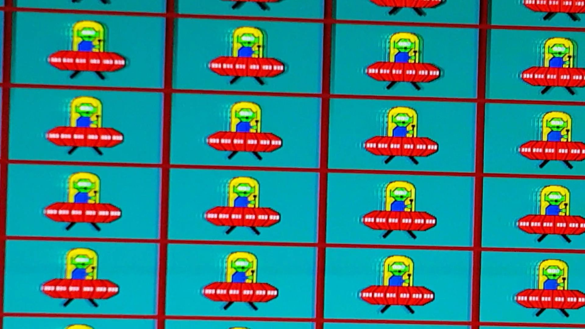

I have two Benq monitor, the xl2411z and xl2546.
When I turn on the blur reduction on my 2411, after using strobe utility, the image is completely clear at 144hz.
I try to get a clear image with the 2546 at 240hz but the best image I can get is this (same problem at 144-120hz):
Someone can help me?

MagneticDev wrote:Hi,
The higher the Hz, the less time to fit LCD pixel response between refresh cycles:
The smaller the vertical total, the less time to fit LCD pixel response between refresh cycles:
-- You can thin the crosstalk zones by using bigger Vertical Totals and/or lower Hz (maximal benefits occurs when you do both simultaneously).
I suggest lowering your refresh rate to roughly 180-182Hz to create more time between refresh cycles:
For other custom refresh rates, try Appendix A of Advanced Crosstalk FAQ.
