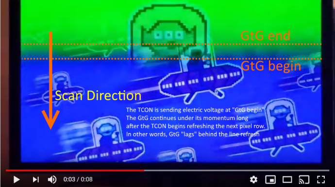

<TECHNICAL>Maelstrom wrote: ↑30 Nov 2019, 15:13Could you elaborate a little here. I understand that the strobing is constrained by having to wait for the pixels to transition to the new frame but is it not as simple as simply waiting till almost the end of the refresh cycle for an ON state on the backlight?
My concern is whether manufacturers are simply leaving the ON state of the strobe light for too long compared to the time of the OFF state for a given cycle at 240Hz. I'm wondering if that is a technical issue (as in it is technically difficult to pulse a backlight to full brightness in a for a single millisecond with very little wiggle room for timing) or simply an oversight.
No LCD exists that can do low strobe crosstalk (measurement criteria: <1%) at 240 Hz
(1) Please study the GtG versus MPRT page:
Pixel Response FAQ: GtG Versus MPRT
TL;DR: Pixel response often takes 10x longer for GtG100%.
(2) Strobe crosstalk is still visible below GtG10% and above GtG90%.
(3) Once a refresh cycle reaches the bottom, it must finish GtG BEFORE the light turns on BEFORE the light turns off BEFORE next refresh cycle begins. Please watch the high speed videos of LCD refreshing
Basically, for low strobe crosstalk the backlight MUST stay OFF until (end-of-refresh-time PLUS GtG99% time). The GtG fade zone is often much bigger than the VBI at 240 Hz. Much, much, much taller than the height of the blanking interval (which is seen as the black bar if you roll the VHOLD adjustment on an analog TV).
Cramming GtG into VBI is an exponentially difficult task. The VBI needs to be long enough for grand total of (~GtG 99% duration + strobe pulse length duration). If you flash too briefly, the picture is too dark. So you need a VBI long enough to flash the light long enough to be sufficiently bright. You can flash for 0.1ms or 0.2ms but that's too dim. Most strobe backlights need to flash a full millisecond, and the VBI is often not that big. 1ms is a whopping 25% of a 240Hz refresh cycle (1/240sec = 4.1ms).
So, again, no LCD exists that has near-zero strobe crosstalk at the full 240Hz refresh for the full screen height. You can get pretty close for the middle 1/4th or 1/3rd on some panels, but will have extremely tall crosstalk zones at the top/bottom, compared to lower refresh rates.
TL;DR: You definitely, definitely, definitely, definitely need headroom. The panel needs to scan faster than the refresh duration, in order to create the longer blanking interval necessary for hiding the GtG between refresh cycles, AND still have enough time left over for the desired strobe pulse width.
