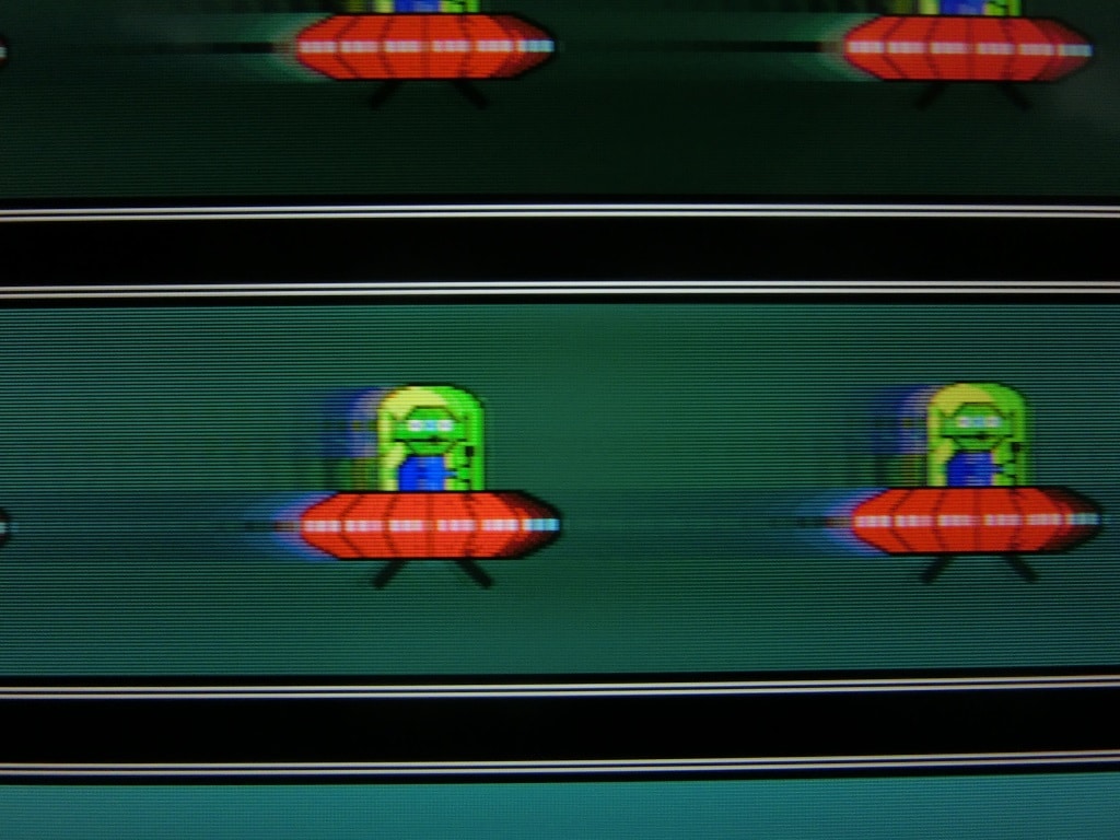

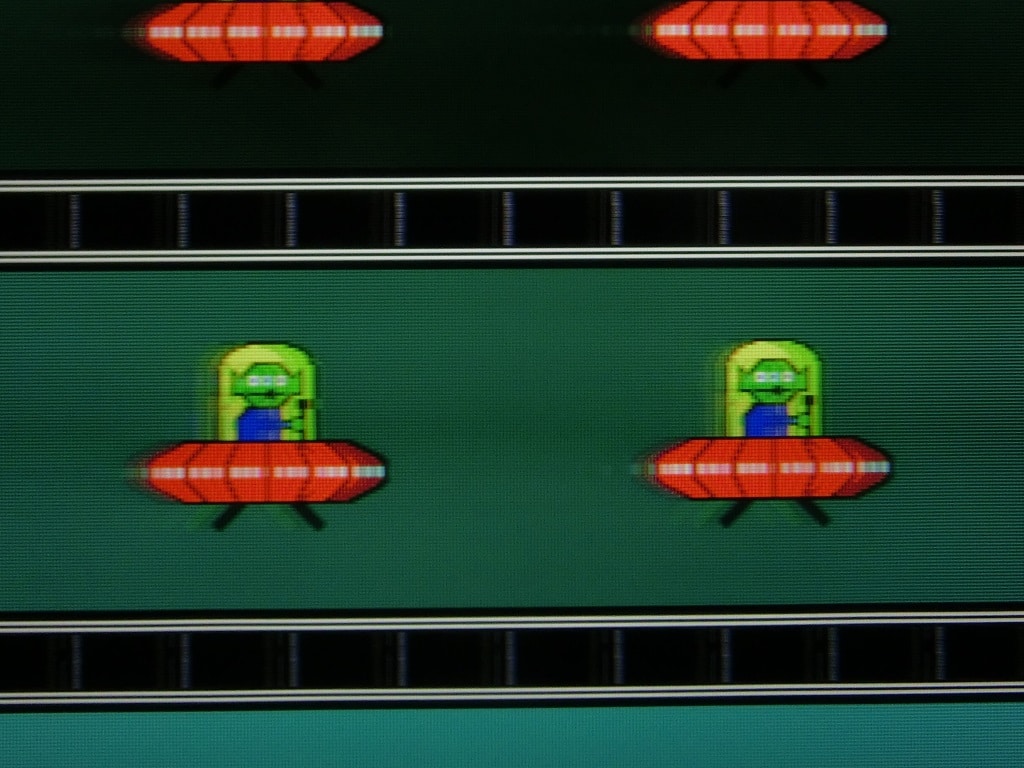

- Posts: 12274
Re: Is Bodnar input lag tester accurate?
VA panels certianly have much slower response. That said, it isn't that bad -- the Eizo monitor actually gets much better when warmed up for 30-45 minutes.aufkrawall wrote:I had that particular Eizo monitor.
Picture was sharp in motion, but unfortunately, there were excessive color mix ups. VA panels always have some very high single response times.
Cold Eizo FG2421:
Warm Eizo FG2421:
So make sure your FG2421 warms up first, to get the best motion quality.
