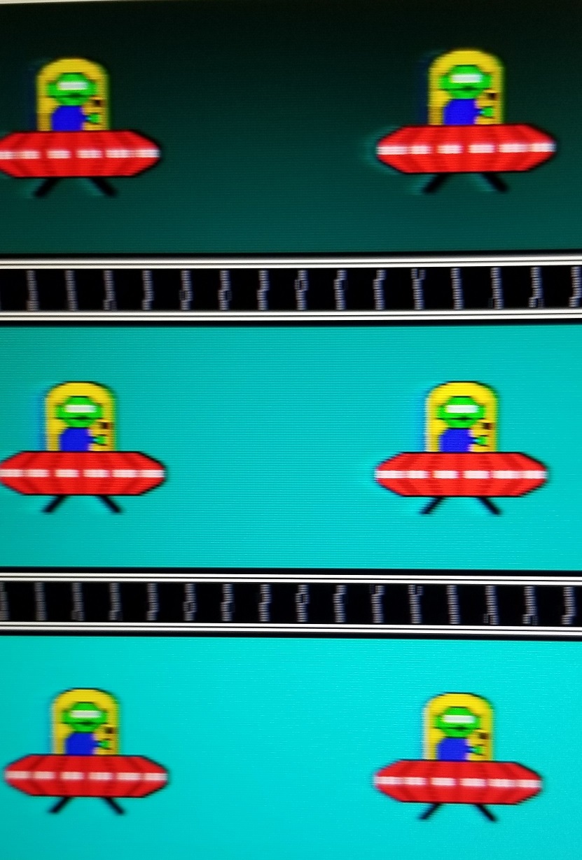

DYAC+ OFF AMA PREMIUM
2 dyac off ama prem.jpg (269.3 KiB) Viewed 145157 times

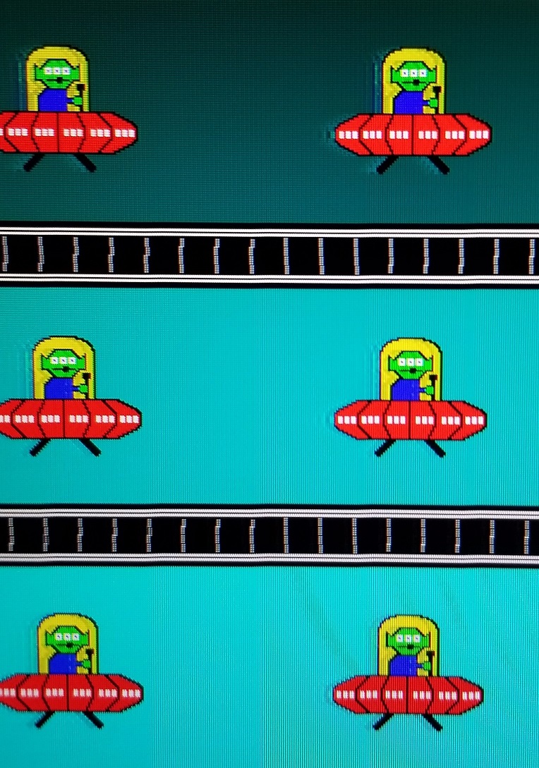

DYAC+ PREMIUM AMA HIGH
3 dyac premium ama high.jpg (353.48 KiB) Viewed 145157 times

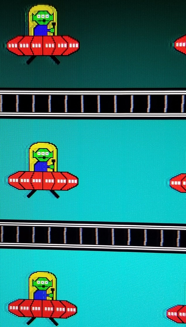

DYAC+ PREMIUM AMA PREMIUM
4 dyac premium ama premium.jpg (334.34 KiB) Viewed 145157 times
I recently just tried dyac+ premium along with ama premium and it felt good. I felt it was a little sharper and more responsive but very slightly. (I don't know if its placebo) I feel after playing a game for awhile things seem to flow naturally and you tend to focus less on the minute details of say overshooting or artifacts if there was any. Maybe I just don't know what I was looking for but things felt natural for me and I had no problems.
thanks man for the pics ! : )
damn, that really looks good to me to be honest, i'm impressed by Benqs crosstalk calibration and overdrive implementation here!, I would say that at 240 hz that is the best result i've seen to date most likely, I also saw and read on this forum some examples of users minimizing overdrive and artifacts even further on high-hz strobing by adjusting colors and contrast on the monitor OSD settings,
