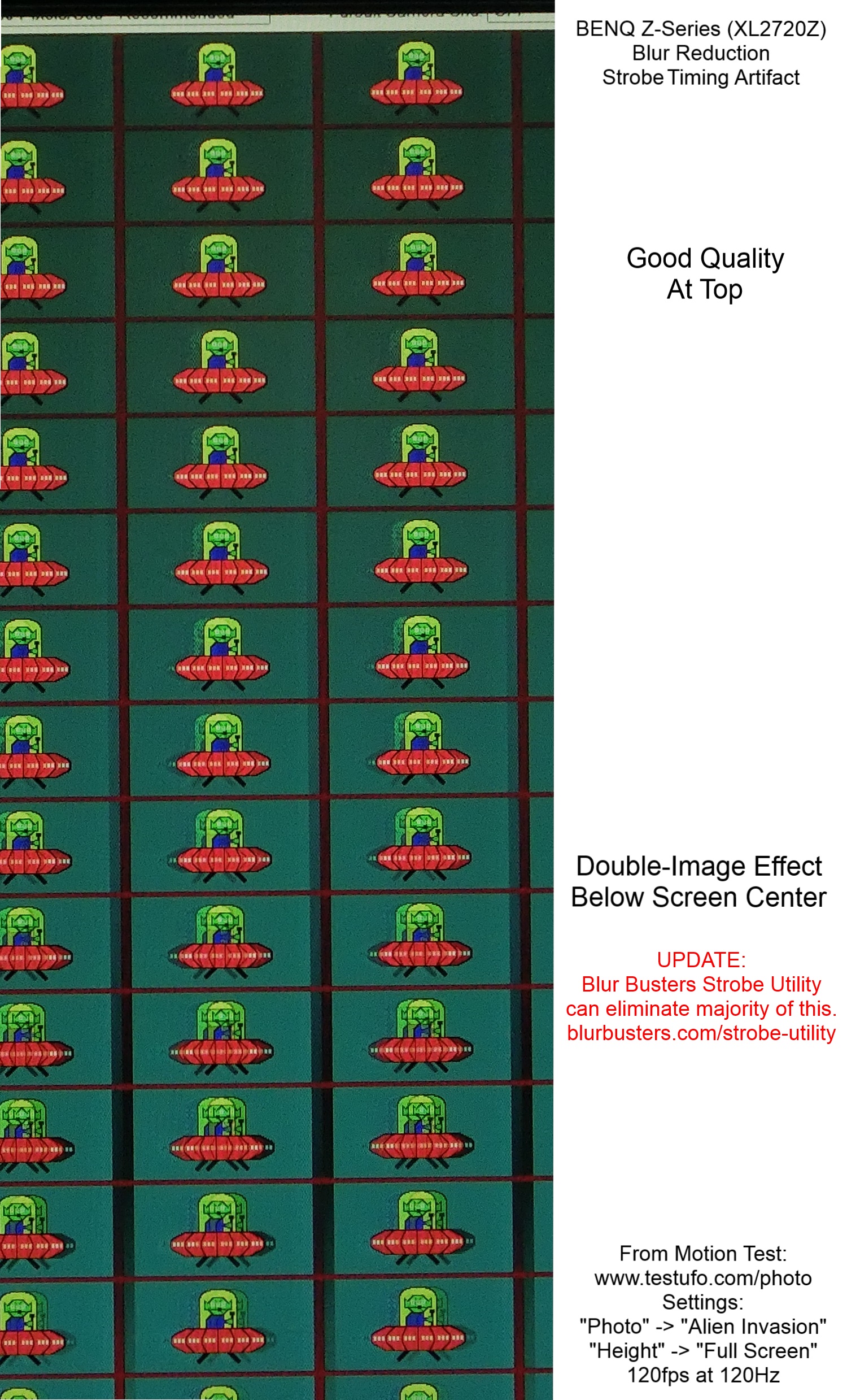

To top it off, strobewidth manipulation is very problematic for strobe crosstalk (e.g. double image effect caused by incomplete GtG leaking between refreshes, caused by a large strobe width too big to fit in the VBLANK between refreshes; leaving no time for GtG to finish between refreshes). Rather than doing that, it's better to blend in continuous-output light; so you've got simple motion blur gradually returning, rather than blurfree -> transitioning to ugly double image effect (on longer strobes) at medium frame rates -> transitioning to PWM-free at low frame rates.
Strobe crosstalk becomes worse on BENQ Z-Series in Blur Busters Strobe Utility at larger persistence settings, because the strobe flash is longer than the pause between refreshes (blanking interval), so you've got a backlight pulse showing two refreshes; creating a double image effect, similiar to: http://www.blurbusters.com/wp-content/u ... pdated.jpg
Real-world 1ms GtG creates strobe crosstalk about 1/8th screen height on an 8ms refresh cycle (1/120sec refresh)
Real-world 2ms GtG creates strobe crosstalk about 1/4th screen height on an 8ms refresh cycle (1/120sec refresh)
Real-world 4ms GtG creates strobe crosstalk about half screen height on an 8ms refresh cycle (1/120sec refresh)
Now, the most common method of eliminating strobe crosstalk on a strobe backlight is to time the strobe flash between refreshes. However, that also means (1) a pause long enough between refresh cycles; and (2) enough time left to flash the backlight.
If you can't squeeze GtG and the strobe pulse between refreshes, you've got strobe crosstalk occuring. That's why people do the large blanking interval tricks (e.g. Vertical Total 1350 or Vertical Total 1500) with BENQ Z-Series to reduce strobe crosstalk.
LightBoost already does this automatically via an accelerated LCD panel scanout (e.g. refreshing the panel top-to-bottom in ~1/200sec during 120Hz, to create the necessary long-enough pause between refreshes to let the pixel momenum of GtG transitions finish to a completely refreshed image (after the electronic refresh finished) before finally flashing the backlight on a fully-refreshed frame. You can see high speed videos of LCD refreshing, which are simply high speed videos of http://www.testufo.com/flicker to allow studying the GtG (pixel transiton) behavior of an LCD.
What the above knowledge means, is gradual lengthening of strobe width, is, in other words, a very bad idea -- from a visual artifacts perspective. When the strobe flash length becomes longer than the VBLANK (the pause between refreshes), you get the strobe crosstalk (double-image effects that look like 30fps@60Hz or 60fps@120Hz) caused by the same backlight strobe illuminating the final part of the previous refresh, and the first part of the next refresh cycle. So you must keep the motion-blur-eliminating strobe short enough to essentially fully fit between the refresh cycles, to eliminate the strobe crosstalk artifacts. Instead, you really simply want to gradually blend the PWM-free to strobing.

Trip wrote:Does this also mean lcd response time is effectivly improved since all the pixels are activated earlier?
No difference to GtG.
By asking this question, it sounds like you still are confused.
So, let me re-explain.
The large vertical totals are tweaks that simply helps the "sweep refresh" finishes quicker, and pause longer between refreshes. See the sweep effect in high speed video of an LCD refreshing. That's the LCD being scanned.
The goal in strobe backlight science is to let the sweep completely finish (in total darkness) before flashing the backlight, before beginning the next refresh cycle. If you don't do the sweep fast enough (e.g. the slow refresh scan of a 2007 LCD), you are beginning to refresh the top edge of the next refresh cycle before the GtG momentum of the bottom edge finishes during the previous refresh scan.
5ms LCD at 60Hz, during regular 1/60sec scanspeed per individual refresh
Top edge of screen: refreshed at T+0ms. Pixels become fully visible at T+5ms
Bottom edge of screen: refreshed at T+1/60sec. Pixels become fully visible at T+(1/60sec)+5ms
See the problem? It takes longer than a refresh cycle for the pixels at the bottom edge to become visible. Your GtG transitions are perpetually ghosting between refreshes, like in the 2007 LCD high speed video.
5ms LCD at 60Hz, but at accelerated 1/120sec scanspeed per individual refresh, while still running at only 60Hz
Bottom edge of screen: refreshed at T+1/120sec. Pixels become fully visible at T+(1/120sec)+5ms = less than 1/60sec total
Now you've finished your GtG transition in less than 1/60sec. You've finally created enough time to do a clean strobe backlight flash, without creating strobe crosstalk caused by incomplete GtG
Now, to let the pixels settle and finish its GtG momentum (pixel transition momentum still occuring after the LCD panel is electronically refreshed) -- you want to finish refreshing the whole panel sooner in a refresh cycle, before you strobe the backlight, before beginning the next refresh cycle.
