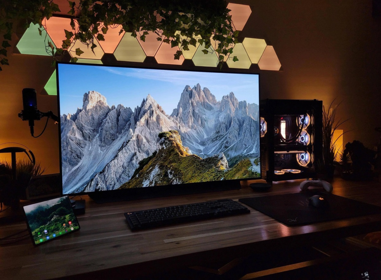

Here is a beautiful desktop setup with a 48" monitor:
From: https://www.reddit.com/r/nvidia/comment ... 090_build/

Re: Using a HDMI 2.1 TV as a monitor [Cheap 4K 120Hz G-SYNC OLEDs]
Nice
